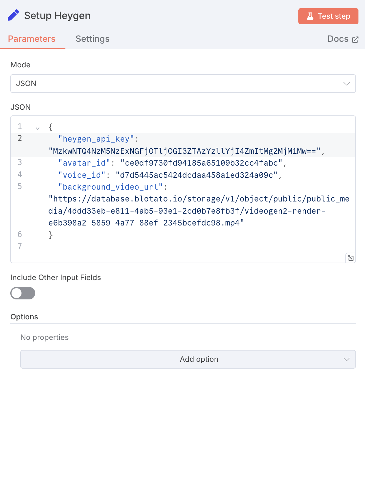

@MrQuarps Hi, which parts have you edited so far? You would need to edit just the ‘Setup Heygen’ node and provide your API, which seems you have, as well as an avatar ID and voice ID. If nothing else is changed, it should work perfectly fine. Let me know, as it is working all okay on my side. Can you show the edit fields node called ‘Setup HeyGen’, please remember to remove any sensitive data.

Yeah, that’s actually the funny part. I feel like that this is exactly what i did. However i had another workflow before and even there i had same issues with jSon, but with a HTTP request and not within the current node.
Anyway, i am providing you the Edit Fields. :slight_smile:

One thing I noticed is the avatar_id—try using “Caroline_expressive_public”. It seems you may be using an avatar group ID instead, which could be causing the issue.
That said, this doesn’t fully explain why other requests are failing as well. Are any requests working successfully, or is this error happening consistently?
The JSON structure appears correct, so the issue may be related to the runtime environment. You could try upgrading your n8n cloud instance to the latest version, or simply restarting it. I tested this on version 1.89.2, but I’ve seen that a few related bugs have been fixed in more recent versions.
