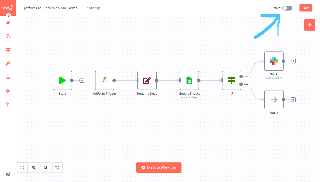

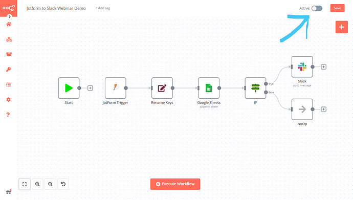

In order for an n8n workflow to always run in the background (without having to execute it manually), you would need to active the workflow using the toggle in the upper right corner of your screen:
Once you enable this toggle, your workflow should do it’s job in the background. Note that you won’t see the incoming data coming in in real-time. Instead you can take a look at previous executions through the executions list in the sidebar on the left:
