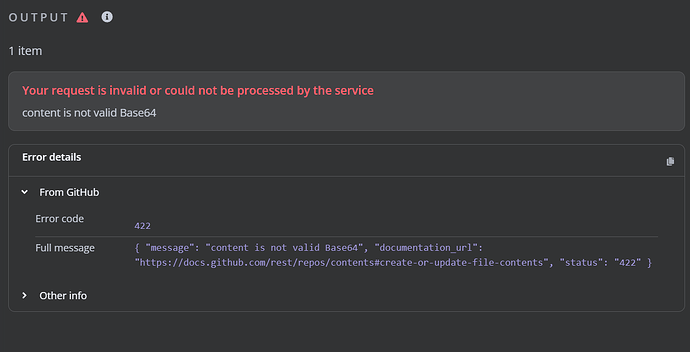

Hi, I have a problem with the GitHub node when trying to save a file. The problem started appearing when I added this variable to my docker-compose.
N8N_DEFAULT_BINARY_DATA_MODE=filesystem
I’m working with large files, and thanks to this, there’s a noticeable improvement in performance. However, some scenarios stopped working.
An error message about an invalid format (base64) appears.
If I remove this variable filesystem and restart the n8n instance, everything starts working again, there are no error messages.
Does anyone have any suggestions on what I can change to fix this?
Thanks!

I have not tested, but based on the error I would assume you must convert the file contents to base64.
Try this node:
Thanks for the response, I can use the node you mentioned - and it will work, using the http node and directly querying GitHub and transmitting the file will also work.
However, I would like to know why using filesystem causes errors, but using the memory storage system does not.
Could it be a bug in the GitHub node?
So, filesystem will now be default and memory storage will be deprecated. (I believe)
Filesystem mode will only output a relative path if trying to access the binary object. Memory storage will provide the file data. It’s inefficient at large scales.
