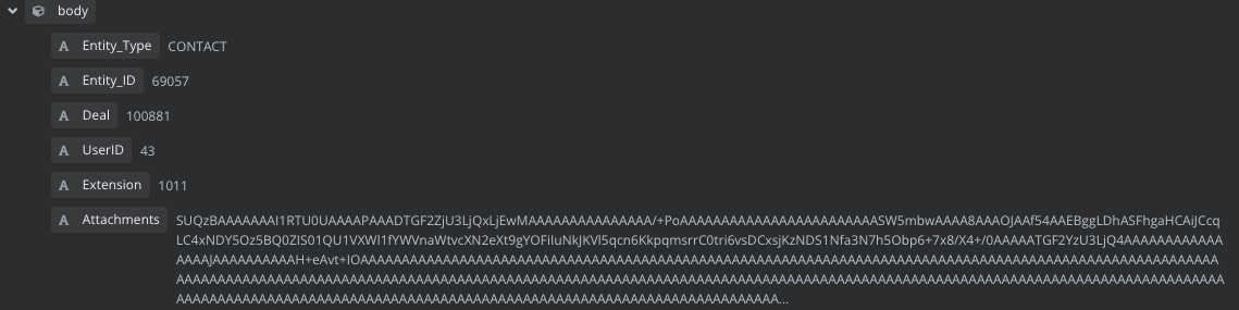

This is how webhook data looks like

This is the data that my home server receives
"headers":
"host":
"31.42.8.56:5678",
"accept":
"content-length":
"1207627",
"expect":
"100-continue",
"content-type":
"multipart/form-data; boundary=----------------------------0e3278c5109a"
"params":
"query":
"body":
"Entity_Type":
"CONTACT",
"Entity_ID":
"69305",
"Deal":
"101173",
"UserID":
"145",
"Extension":
"1031",
"Attachments":
"SUQzBAAA
