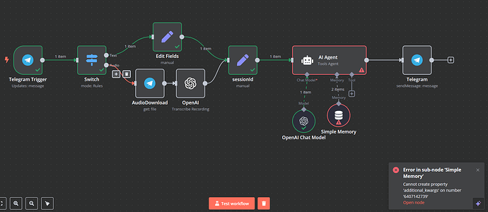

Dear n8n Community,

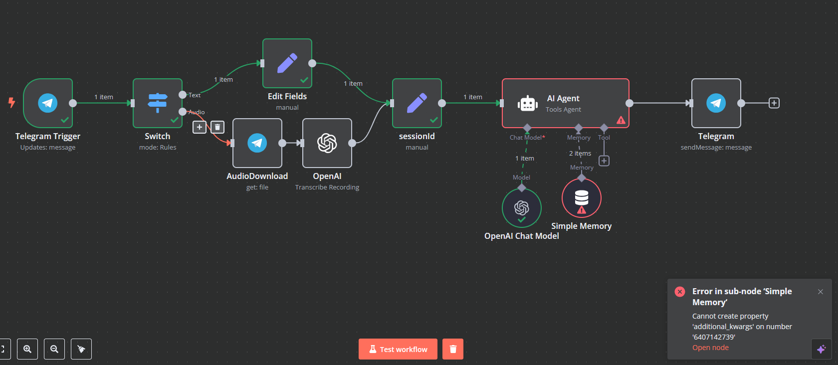

I tried to create an AI agent following the YouTube instructions. Unfortunately, an error occurs after inserting the “simple memory node.”
I first set up a Telegram trigger.
From there, it goes to a switch node that distinguishes between voice and text messages. {{ $json.message.text }} or {{ $json.message.voice.file_id }}
The text message is edited from “message.text” to “text.”

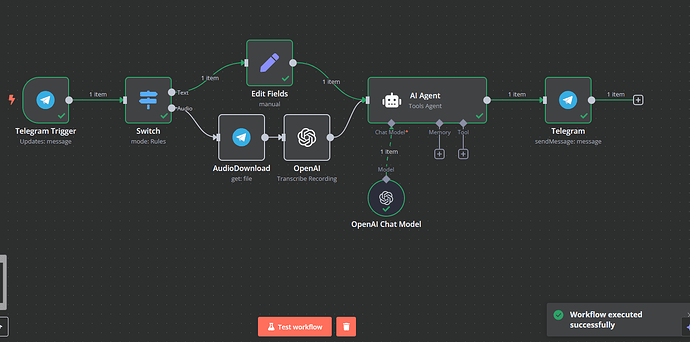

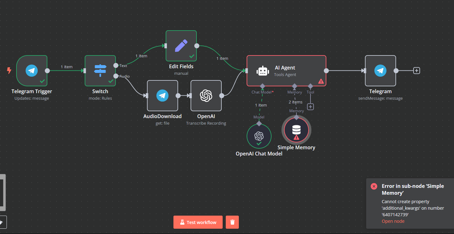

Then it goes to the AI ​​agent. Without the memory node, the output via Telegram works.
When I now insert the memory node and trigger the workflow, the memory node flashes green briefly, but then turns red as shown in the image.
Cannot create property ‘additional_kwargs’ on number ‘6407142739’
  • n8n version: 1.84.1
  • Running n8n via (Docker, npm, n8n cloud, desktop app): n9n.cloud
  • Operating system: Win 11
What am I doing wrong? What can I do?
Thank you for your help.
Best regards,
Andreas

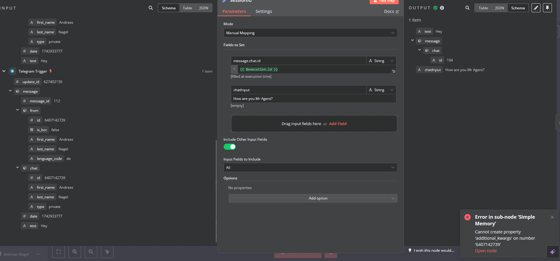

To use the Simple Memory, you need to pass a sessionId, when using without Chat trigger.
I suggest to place am Edit node right before the Agent node
  • Check Include Other Input Fields
  • add the sessionId
  • optionally set / modify chatInput
Thank you for your answer.
I’ll try it that way.
The error remains the same.
I hope I implemented it correctly.
This must be sessionId
The Error remains:
“nodes”: [
“parameters”: {
“assignments”: {
“assignments”: [
“id”: “95e85dda-c46d-4605-82f4-dd7c9da19fb1”,
“name”: “sessionId”,
“value”: “={{ $execution.id }}”,
“type”: “string”
“includeOtherFields”: true,
“options”: {}
“type”: “n8n-nodes-base.set”,
“typeVersion”: 3.4,
“position”: [
1320,
0
“id”: “81b14efe-cd0b-4adb-9031-716e8e5262a2”,
“name”: “Edit Fields1”
“connections”: {
“Edit Fields1”: {
“main”: [
“pinData”: {},
“meta”: {
“instanceId”: “31ca1c67a3c7e76535e44397c465cad5d69925544f50cfe7ba32b9a7bf7a61fc”
Sorry.
It did work.
Thank you very much for your help.

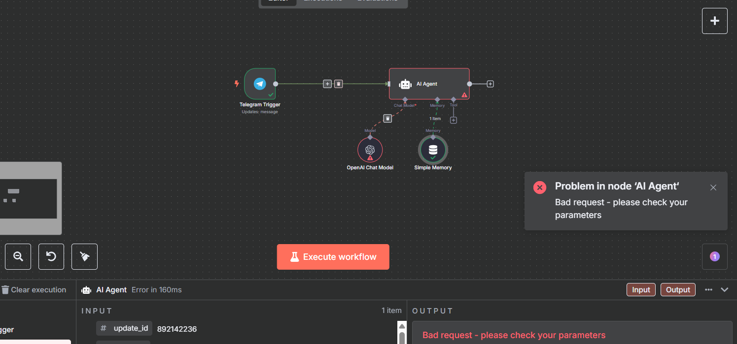

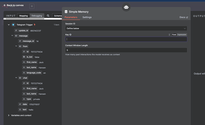

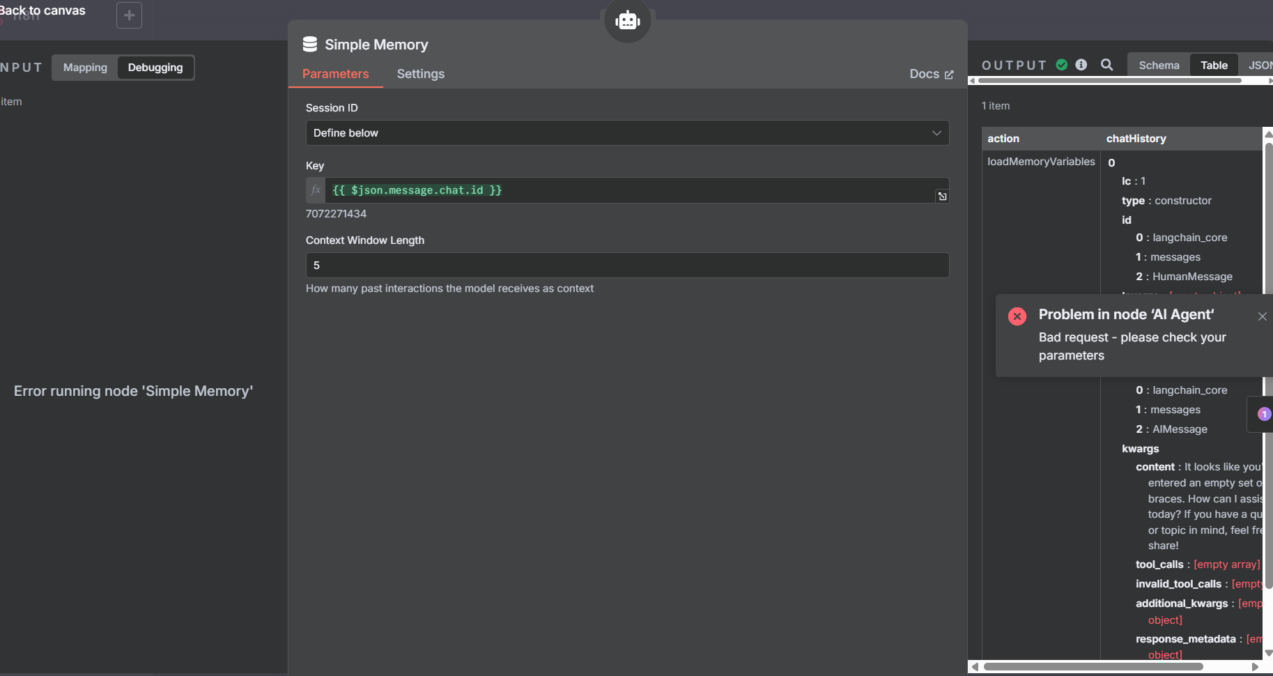

Hi, I see you’re having the same problem.
You can solve it by setting the Telegram Trigger ID to Simple Memory.
Simple Memory Settings
Define below
Key
message_id ---- X
And that’s it
Hello,
I am very new to the N8N community so this question may seem under informed, but what are you actually putting into your simple memory settings?
I dragged the message id schema into my simple memory key, but I am still getting the same error as before.
