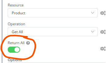

Yes, right now I have 10,300 products in the database, but it only allows me to import up to 100 products and if I try to import all at once it gives me the error.

Thanks @Alejandro_Bonnin, it’s quite helpful to see this is happening only for a larger amount of products. Based on this info I assume the problem would then only occur if the Return All option is enabled (as in your example workflow) but otherwise the node is working fine?
Maybe there’s a problem with the pagination logic then. I’ll insert some more products in my store next to see what happens.
I could not reproduce the exact error you have described though @Alejandro_Bonnin. The split method from the error trace you have shared refers to the response headers received from WooCommerce, which for some reason does not seem to be available in your example. I wonder if this might just be a side effect of the problem I have noticed.
Let me fix the pagination problem first, maybe this also addresses your issue
