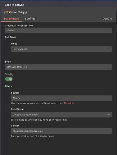

This is the configuration of the gmail node:
There is no error. As I said, it works normally if I trigger it manually, the only problem is that it doesn’t trigger.

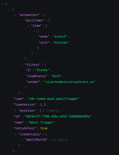

I checked the other query you provided, and I see my flow there, but checking the nodes column I don’t see anything odd in the parameters:
It’s worth mentioning that I have other GMAIL flows that seems to work fine, so there must be some problematic thing on this specific trigger that I can’t find.

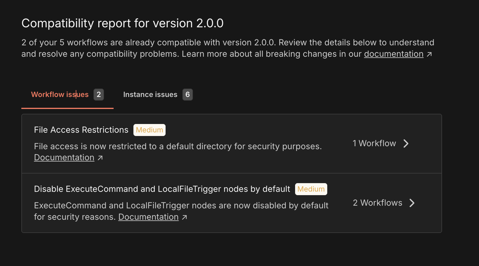

I see there is a compatibility report:
The file access restrictions can be easily fixed (I just use /tmp folders, I can point them anywhere else, not as convenient, but ok). But the ability to not be able to execute commands limits what I can do with external binaries. What is the official workaround?
@danielo515 n8n has not removed that , it is just has been disabled. You can always enable that:
If you do not want to use execute command node you can also try using some different machine to compute the binary files and access them via http or ssh, although if your use case is not at production scale you can use execute command node.
