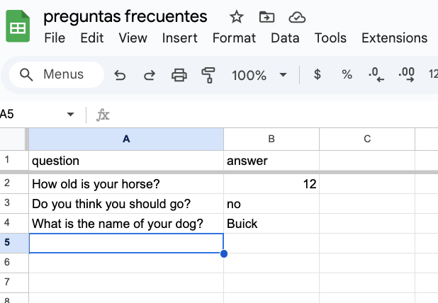

Hola @pruebaia24 - I’ve just replicated your workflow and it’s working for me - I think you may just want to double check the method of question and see if you get the answer. but I can see it is accessing the whole sheet as expected.

just a hunch but can you test How can I schedule a call? instead off Hi, How can I schedule a call?
Actually I did manage to replicate this issue - I repaired it by going into Chatbot_web and removing/adding back the chatinput varible. for some reason this worked for me.

last comment from me: I think you would be best just removing and re-adding the googlesheets node. create new google credentials to force it to re-check that excel sheet you have. that’s the only element that seems to be the cause of the issue. Please do let us know if you get this resolved!
