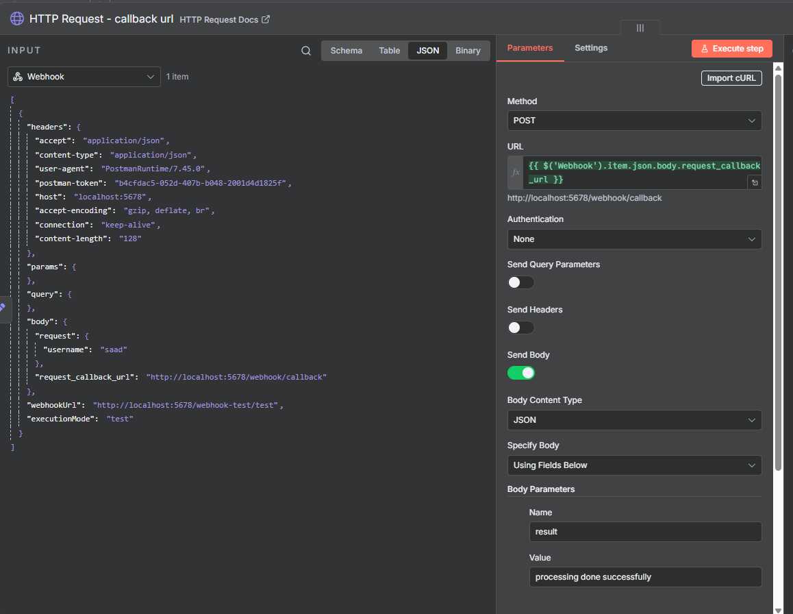

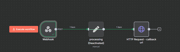

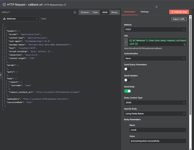

@LorenzoG
Your n8n webhook receives a request (e.g. from Instantly), and the request payload contains a field which is a callback url (its name can be anything, and in your case this will be an Instantly Webhook), e.g. in this sample workflow i created for you the request body is :
"request": {
    "username": "saad"
"request_callback_url": "http://localhost:5678/webhook/callback"

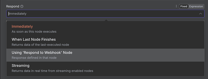

Also your respond with “Immediately” in webhook with a 200OK status with a custom json response if needed :
Then you do your processing, whatever your workflow logic is, and after that in the end you do an HTTP Request call to actually call the “callback url” you received in the input webhook, and respond with your desired output data/json to Instantly :
So this way, your Instantly webhook (that calls this n8n workflow) will get an immediate response and not a timeout (unless there is a network issue) > your n8n workflow will do all the processing > once its done it will notify the caller (Instantly AI in your case) with your desired output json. This is a basic asynchronous processing method for such system designs.
