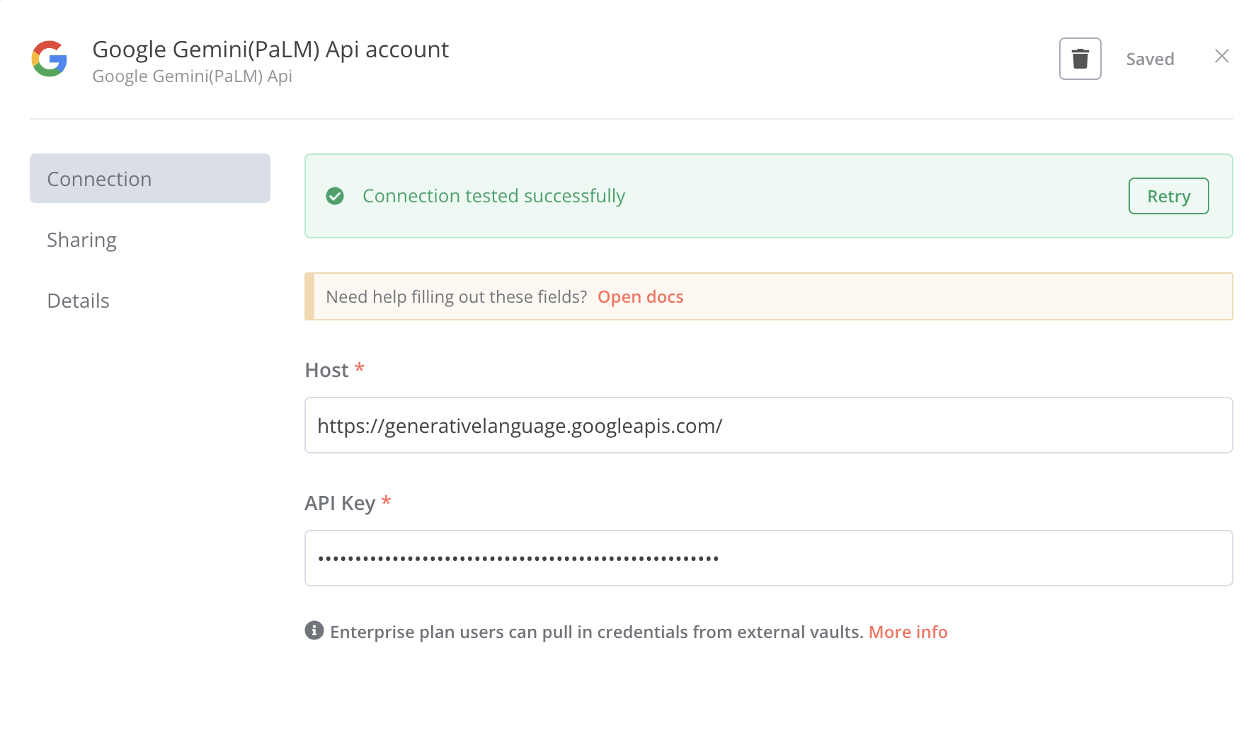

My n8n instance is running in a region that doesn’t have direct access to Google, so I use a proxy server to handle the connection to Google.
I added the following to Docker’s environment variables:
HTTPS_PROXY http://172.17.0.3:7890/
HTTP_PROXY http://172.17.0.3:7890/
ALL_PROXY soket5://172.17.0.3:7891
When I add a Google Gemini Chat Model node, I can add the Credential correctly and load the model list in the Node. This proves to some extent that the Proxy is working properly.
But in actual operation, Node will return a 502 error.
I looked at the proxy server’s logs, which confirmed my suspicion, when I added the Credential and selected the model list, I could see a connection message. But when the node is actually running, the proxy server’s log is empty.
Likewise, n8n’s logs don’t give any errors.
