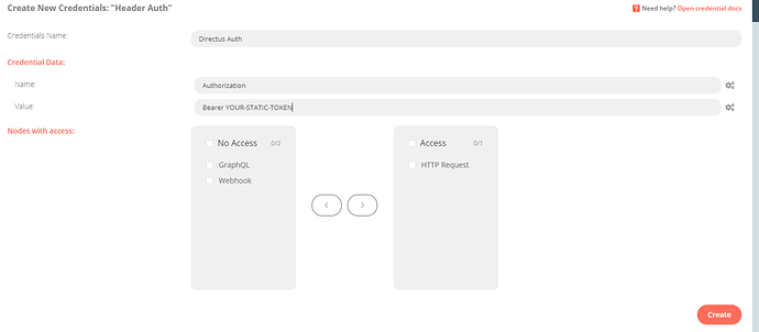

@srob41 As Jon mentioned, in the HTTP node, you should:
  1. Select Authentication: ‘Header Auth’
  2. Credentials > Create New , like so:
Note: In case it’s not known, YOUR-STATIC-TOKEN can be obtained from:
Directus app > User’s Profile > Token
