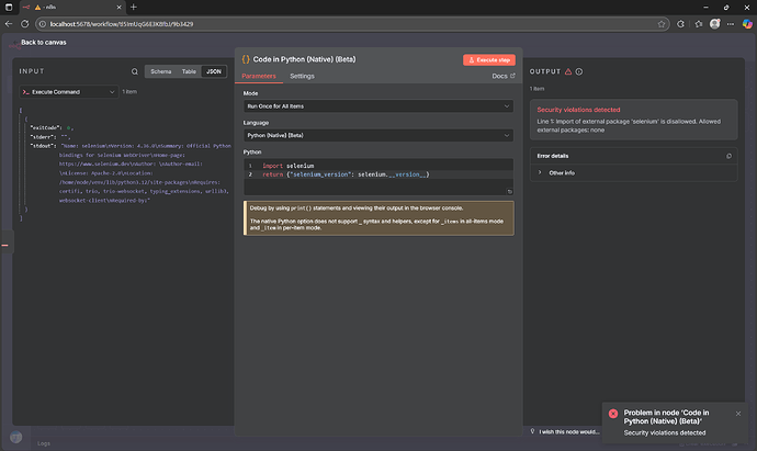

Hi everyone,
I’ve successfully upgraded to n8n version > 1.113.2, which includes the Python Native Runtime and the new Data Table feature. However, I’ve noticed that I still cannot use import statements inside the Python node.
So, I’m wondering:
  • Did I miss some configuration step?
  • Or is n8n currently restricting import usage for security reasons, as mentioned in the documentation?
Additionally, once this limitation is lifted, will it be possible to:
  • Run pip install <library> inside the Execute Command node,
  • And then use that library (e.g., selenium or playwright) directly inside a Python node for web automation or simulation tasks?
Thanks a lot for the amazing work - I’m really excited about the new Python native support and can’t wait to explore more advanced use cases!
