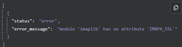

It’s strange because Im trying to apply the code and Im getting this:
