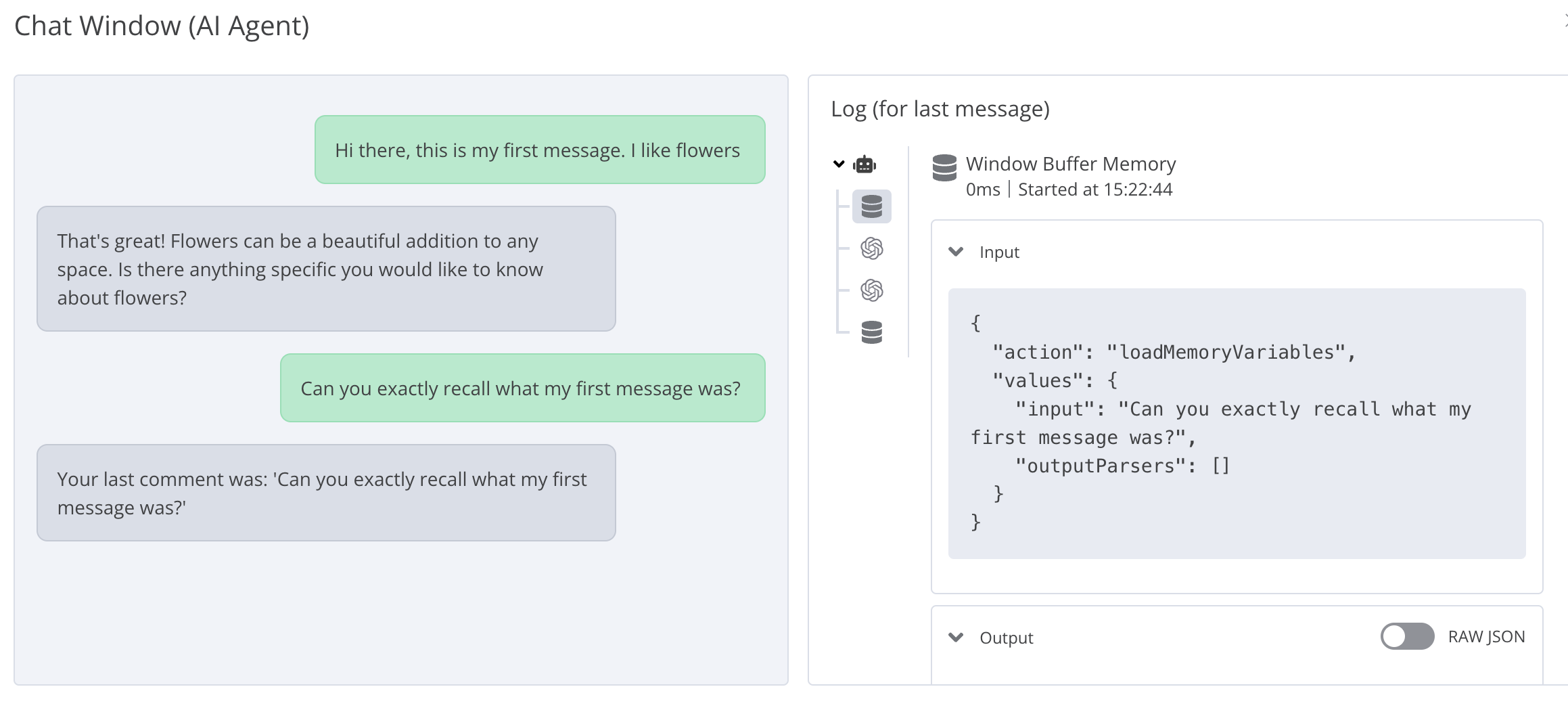

Hmmm so I tried with the following workflow. First manual execution I use the first input, telling the model I like flowers. Second manual execution I use the second input, asking for the exact first input, but it gives me the system prompt I think.
Do I need a permanent store for that sort of thing? I know sb who created a persistent chat with ChatGPT via make and saves the chat id to go back to and continue messaging, I’m just not sure how I would do that within n8n…
Any thoughts, ideas, pointers, etc welcome @MutedJam !
I tried just using the AI Agent with a memory and a manual chat input, but same thing it doesn’t react at all like I’d expect…
Now I’m just passing all my context into a Basic LLM as system prompt every time. This could get out of hand token-wise but probably still better than sending all the conversation history every time. And as I want to score text and get numbers back it’s actually ok to “only” have the system message with instructions as context.
Again, it’s not what I was looking for, works for now, but I’m still keen on learning about the truly conversational approach with persistant stored message history more!

No worries @MutedJam I saw you’re away! Still haven’t really solved it satisfactorily… Sounds like such an easy thing to do tbh and I’m probably just not getting sth, but yeah…
