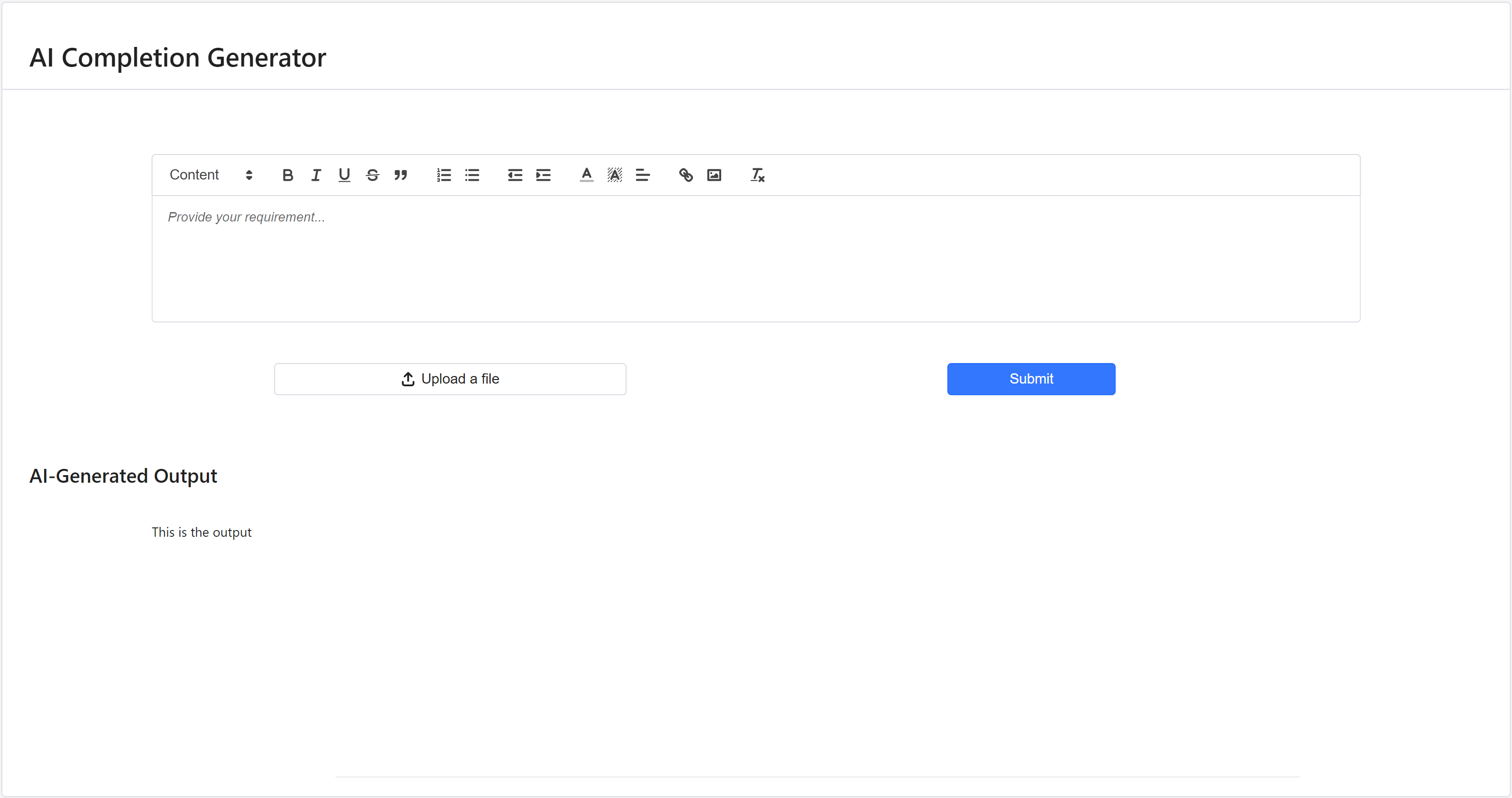

Hi! I am trying to create a simple web app that lets users type in text and add files and generate output using OpenAI’s API. I am trying to use Appsmith/Openblocks for this front end and use n8n to handle everything else. The sample layout is given below:
Here, I have tried creating a webhook node to accept the inputs provided by the users. Whatever they type in the text field, and the uploaded document is received without any problems, and the workflow starts running.
Now, I need to send the output of the last node back to the application. I’ve tried creating a ‘Respond to Webhook’ node, but not quite able to figure out how it functions and everything. How to send the response back to an application after a few seconds (for the workflow to run) and use the last node’s output in the response?
