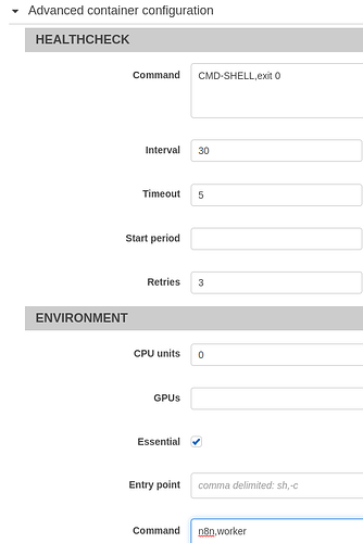

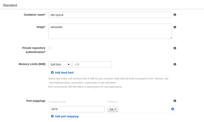

Hi @Jon Here is my Task definition Config:
Hey @guiarjones,
So that looks like the comand is not correct as we changed things in 1.0. In our deployment guides we now only use worker as the command as we automaticlaly apply the n8n part.
Have you tried just using worker to see if that kicks it off?
