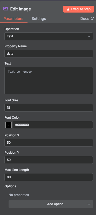

Hello @aipreneur
I think what you’re experiencing is pretty normal with AI image models, They often struggle with rendering accurate text, especially in languages other than English, and even with strong prompting you can still get hallucinations or misspelled letters.
If your main goal is just to display quotes with clean typography, you might want to separate the steps:
  • Use DALL·E (or any image model) to generate the background image.
  • Then use another tool (like n8n’s built-in Image node) to overlay the text in the correct font and language.
Also, keep in mind that the higher the quality of the model you use, the better results you’ll usually get, though this often comes with higher costs.
