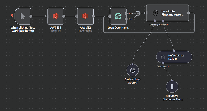

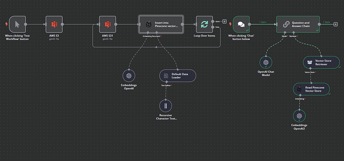

There is only one problem, and that lies in the S3 node. I believe I need two? One for gathering many files, and the 2nd for downloading into pinecone? Essentially, if someone can share a template so that I can ingest multiple files into pinecone for rag, not just one. This can either be from Onedrive or S3, preferably.
Need config setup for S3 nodes
=>multi document rag
Hey @boscocho,
Looking at your workflow you have the right idea, So first you would need to list all of the files in your s3 bucket then use another S3 node to download them. Once you have done that the process you already have will work.
With the workflow you have shared a screenshot of did it fail at all as it looks like it should work although you may need to use a sub workflow if they are larger documents to help with the memory consumption.
just needed the pinecone to loop itself. was doing loads of files. thanks
