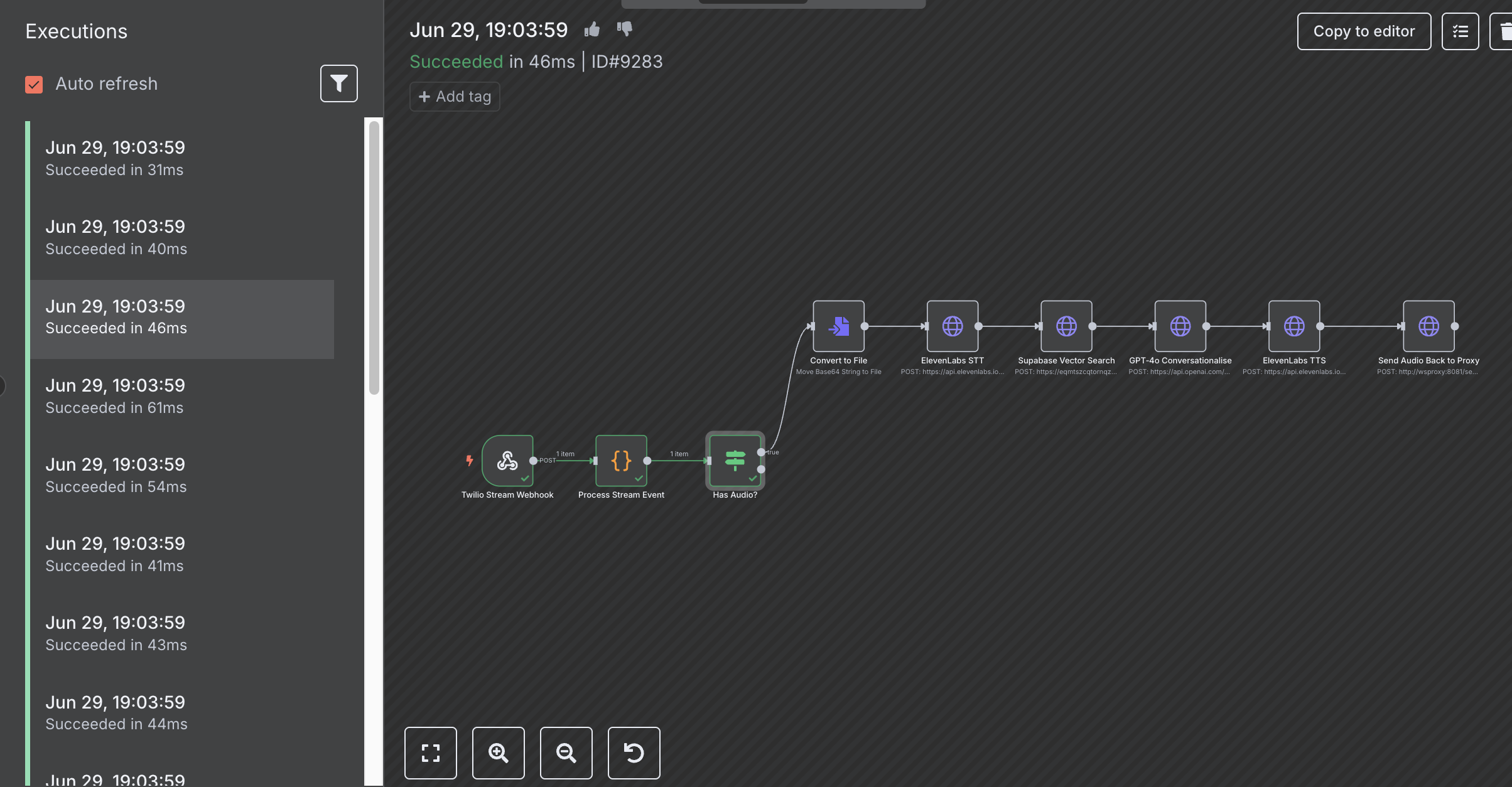

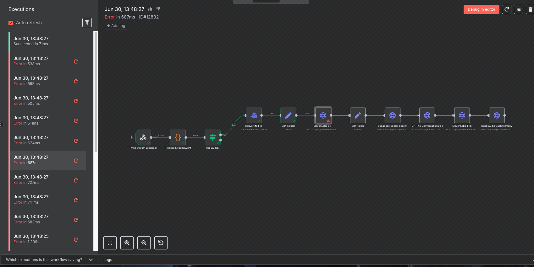

So, I’m trying to build a Customer Service Assistant connected to a database, utilising Twilio, ElevenLabs, Supabase, + 4o >> However, I can’t seem to make the workflow work.
So far, this is where the execution gets me;
Every time I call my Twilio number - the Workflow pops, but no audio is transmitted back to the call, or even to ElevenLabs. I’ve gone round in circles asking LLM’s to fix this, but it just hasn’t worked. Every suggestion they’ve asked me to doesn’t really work and there’s another problem waiting for me on the other side.

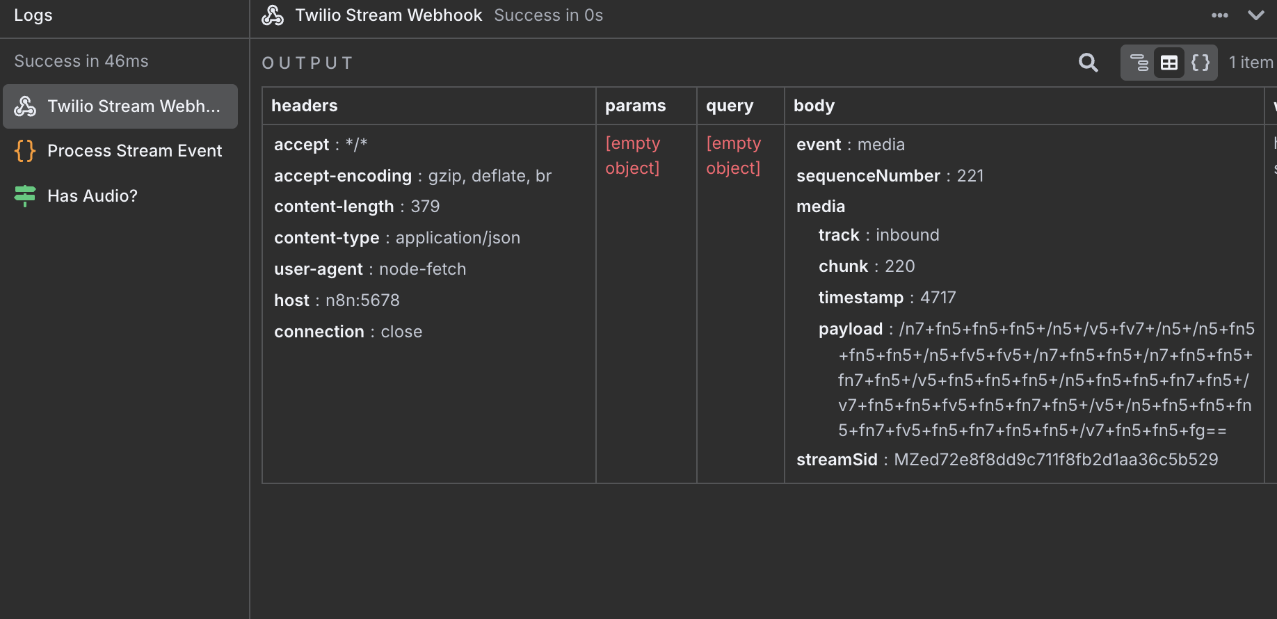

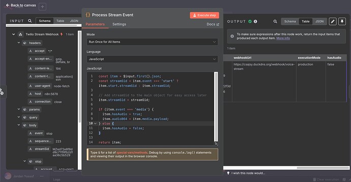

I’ve made sure the ports are all connected, that wsproxy is correctly coded, that the calls get connected via the WS; so really unsure how to go forward.

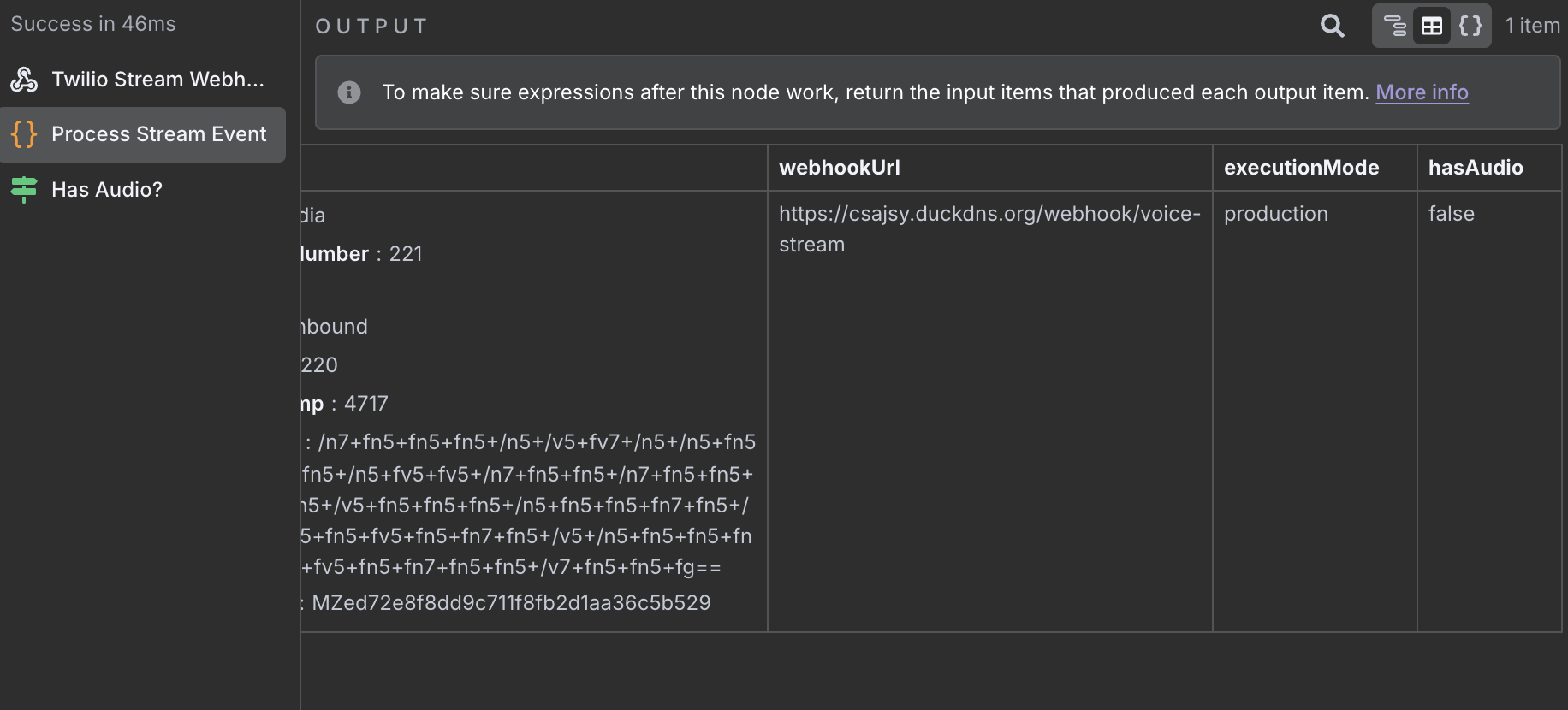

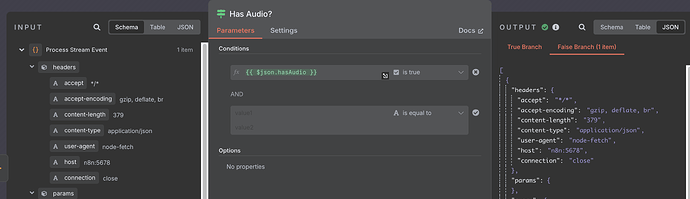

it seems to get stuck in this node, where it doesn’t pass the information through.

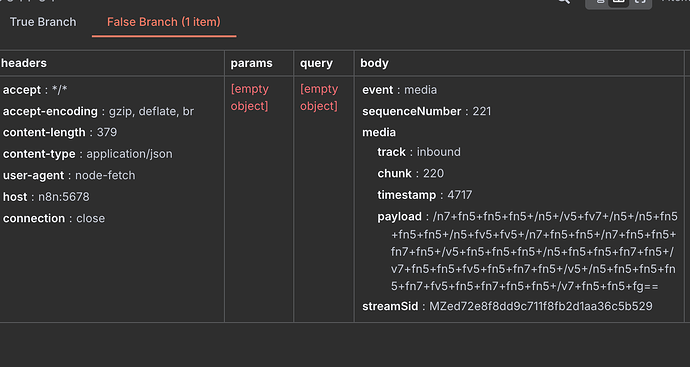

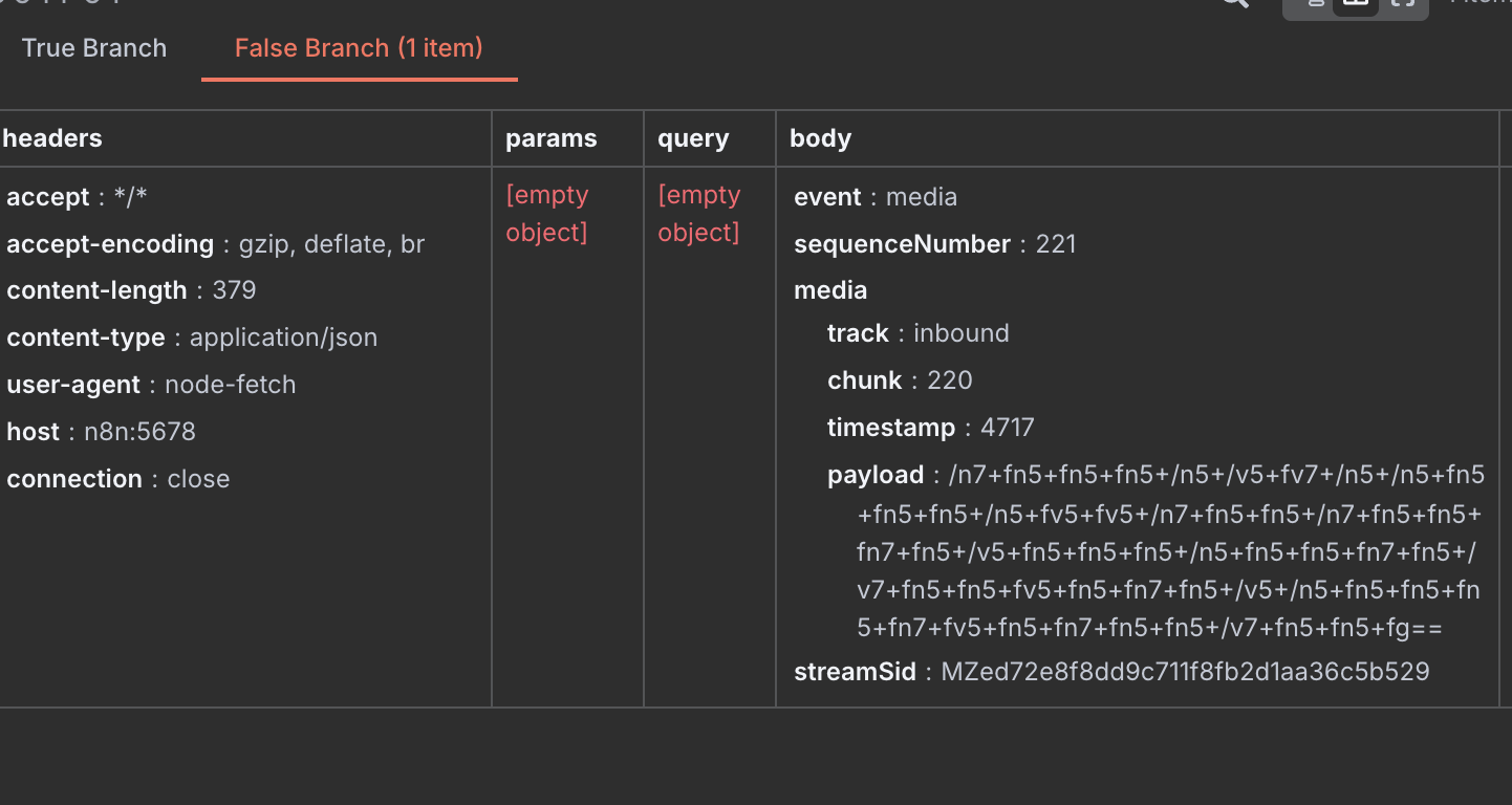

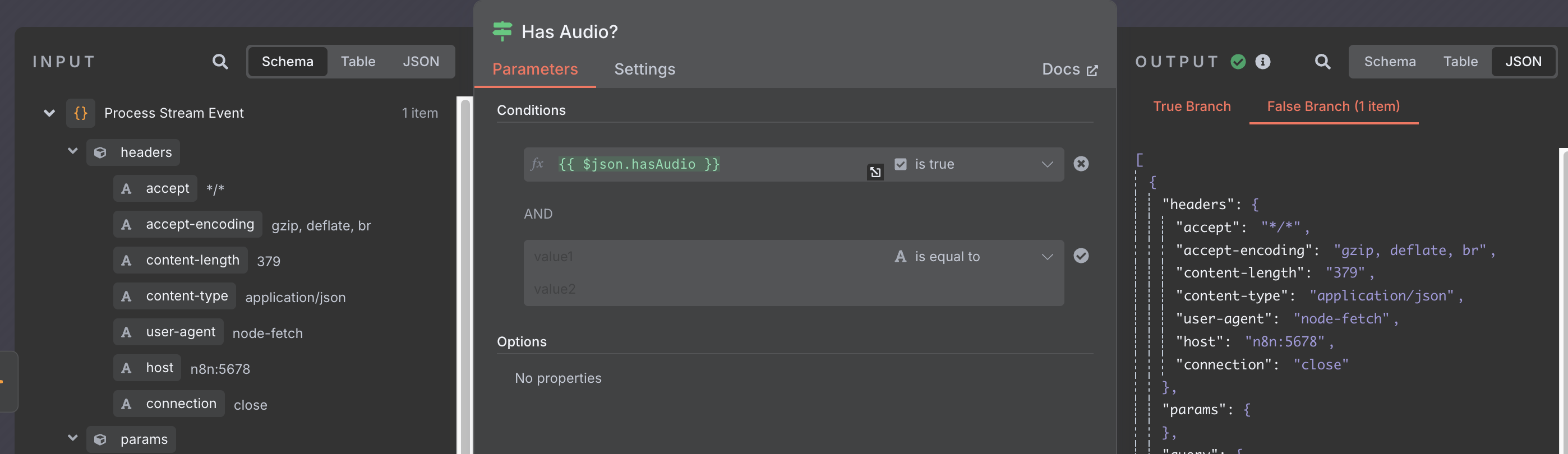

the audio always seems to go into ‘false branch’ and I don’t know why. The WS is connected, but the calls are silent. I can’t hear anything. and it seems neither can the workflow.
It seems the audio isn’t even being passed through.

So i’ve actually managed to solve that issue above now, and I’ve ran into another one.
