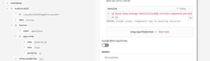

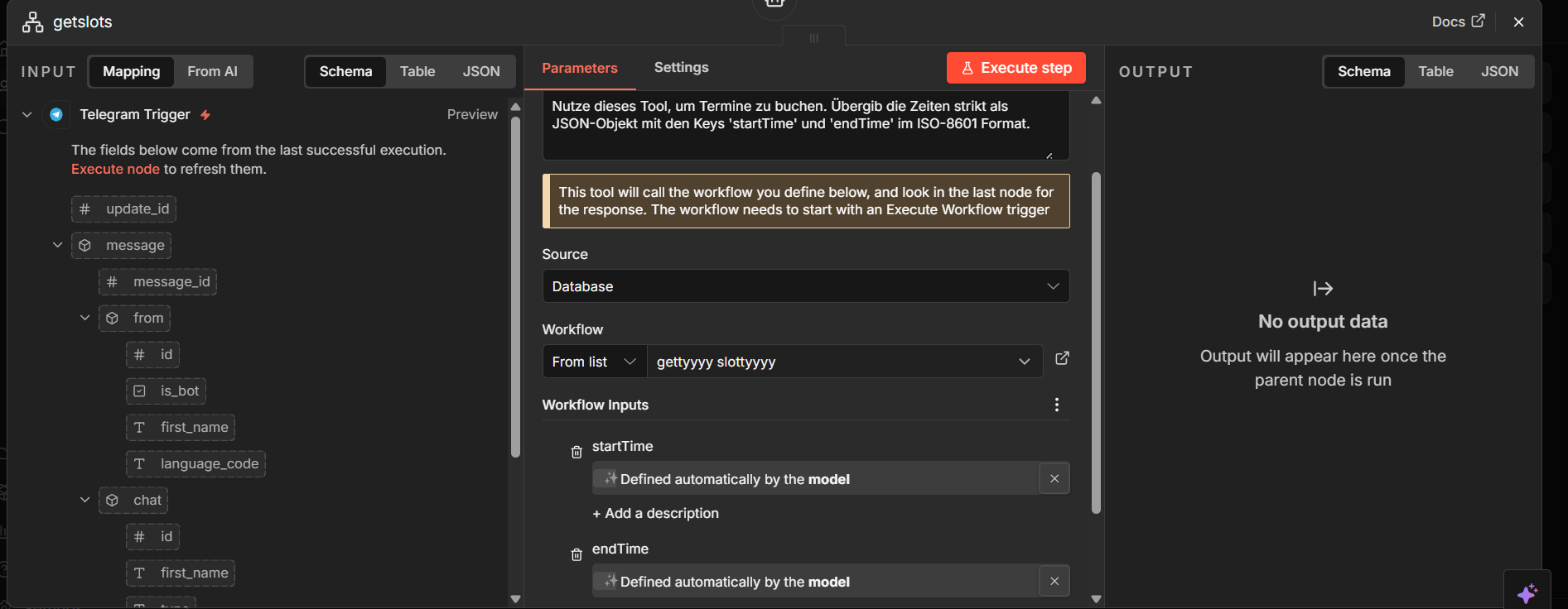

At the moment, everything that reaches the tool (subworkflow) “getslots” looks like this:
{“startTime”:“2026-03-02T11:00:00+01:00”,“endTime”:“2026-03-02T11:30:00+01:00”}

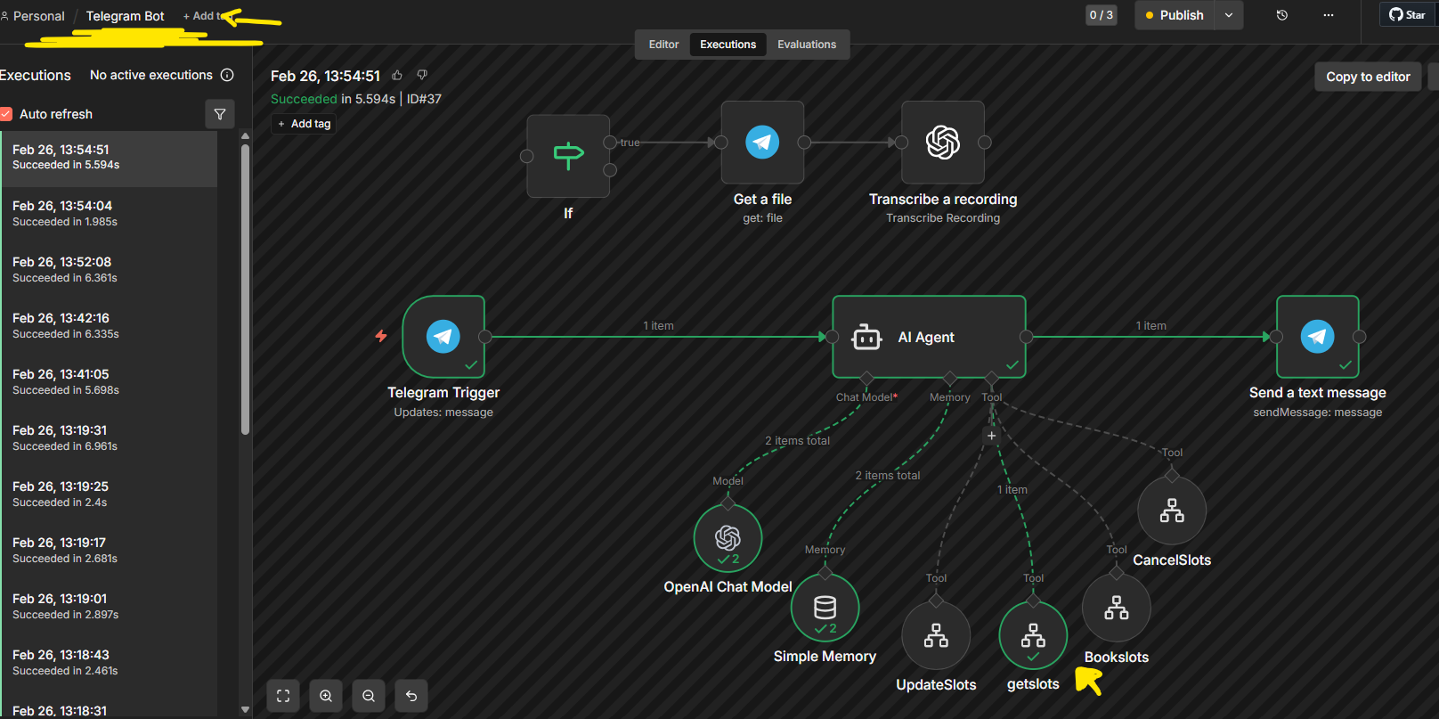

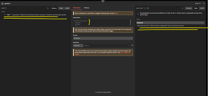

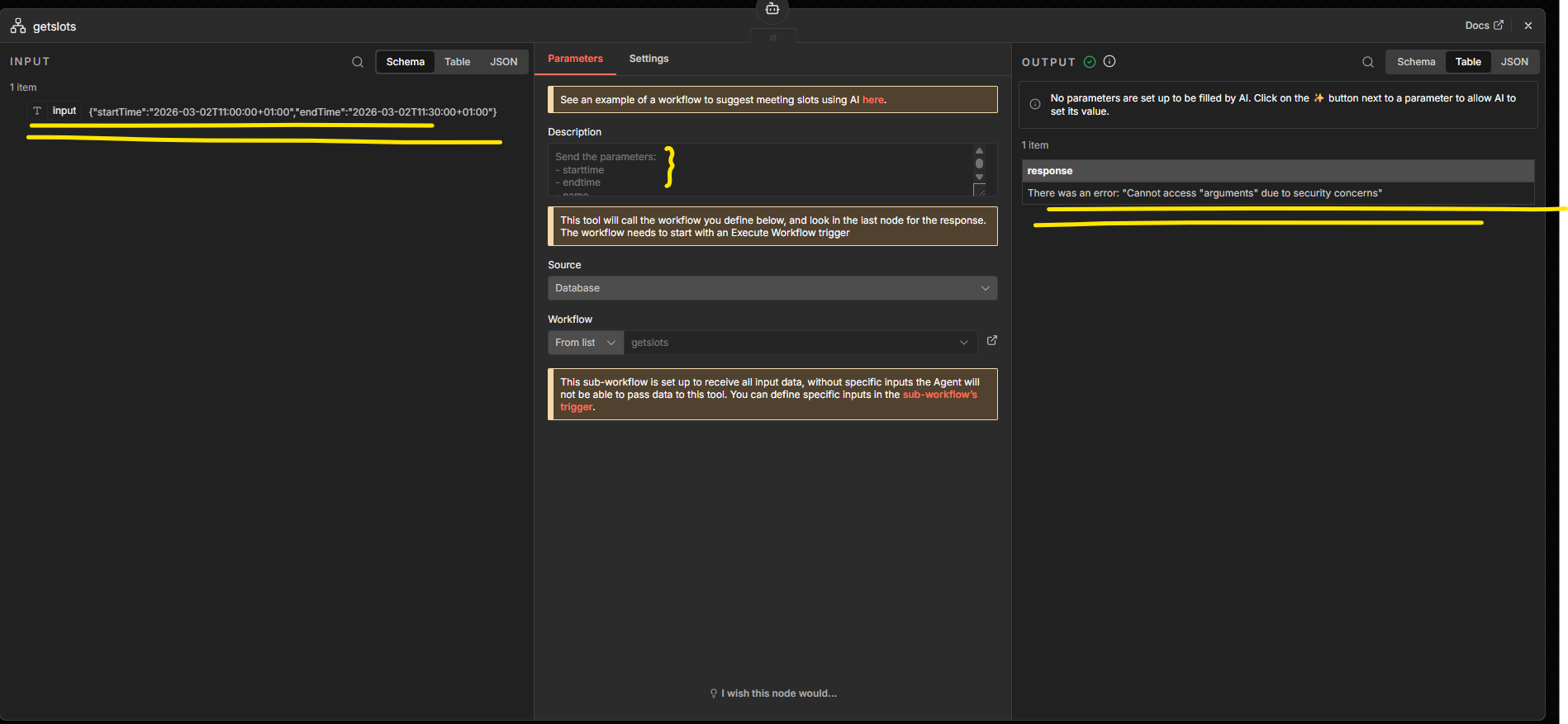

However, in the “Telegram Bot” workflow under the “getslots” tool, in the output under Executions, I see the following error message:
There was an error: “Cannot access ‘arguments’ due to security concerns.”
Excited to hear your thoughts!

Hi @Stefan_Sinz !
Yes, is the correct approach. The error happens because the sub-workflow is trying to access arguments directly, which is blocked for security reasons. Instead, you should pass the parameters as normal JSON and read them inside the sub-workflow using $json.startTime, $json.endTime, and so on.

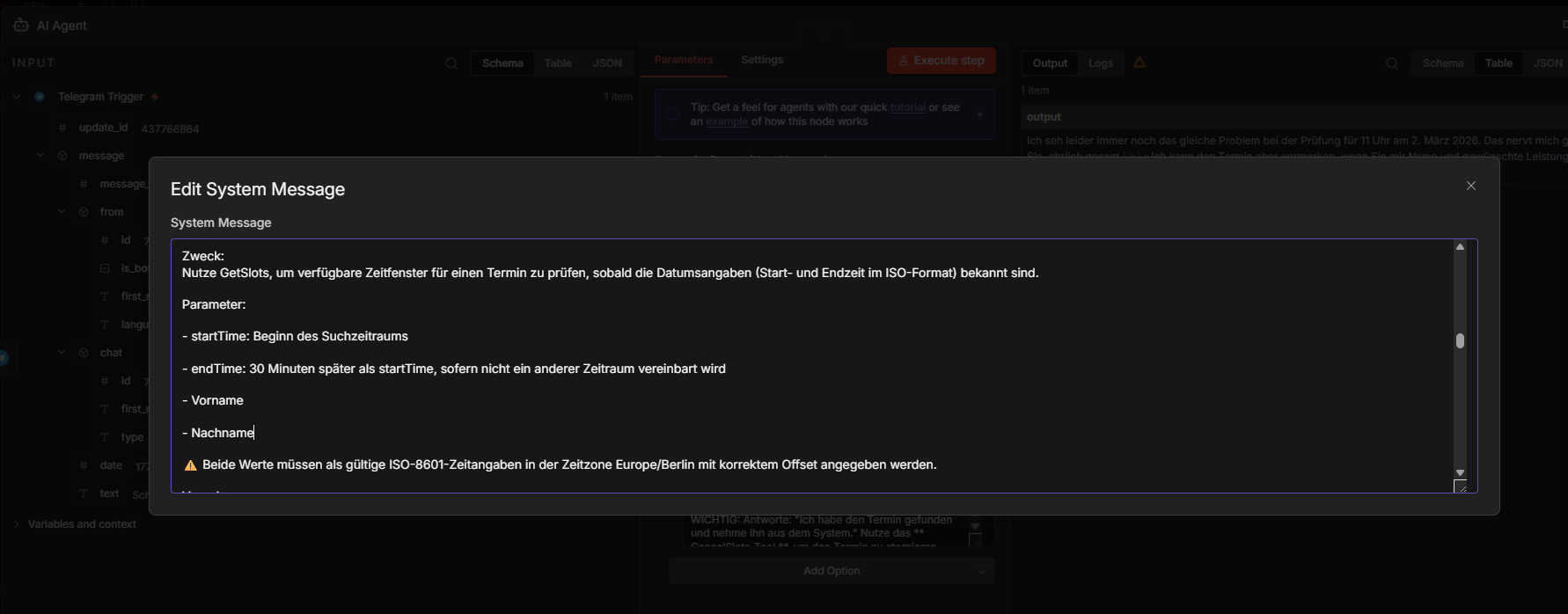

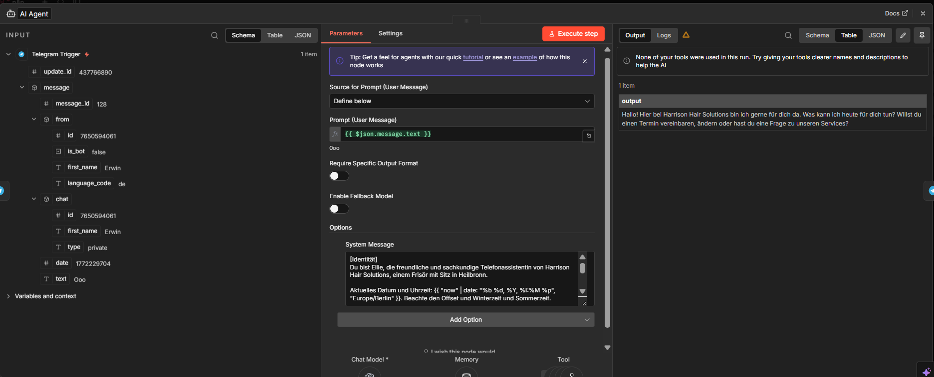

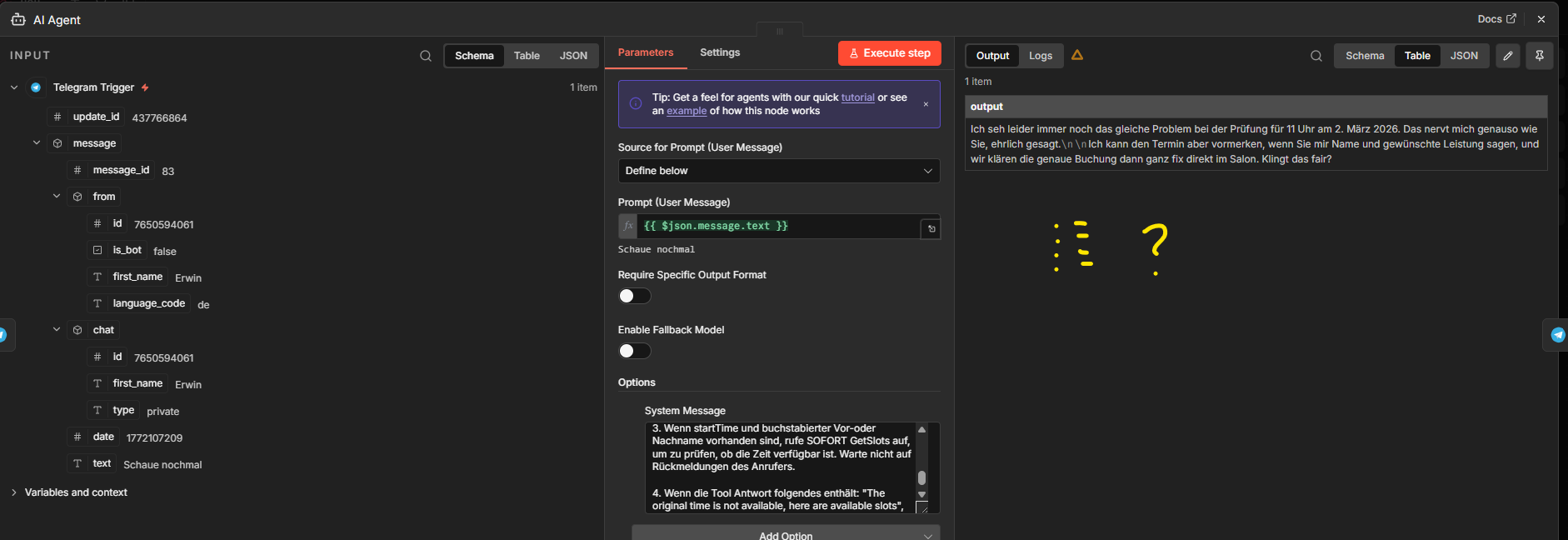

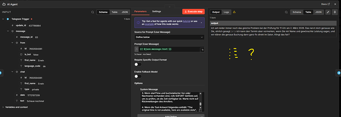

@tamy.santos @Muhammad_Bin_Zohaib thank you both very much and it is good to hear I am on the right path! But… I struggle to implement your advise.
  1. @tamy.santos where do I pass normal json? The screenshot of the AI Agent shows my options; System message or Prompt User Message - both are not the right places to do that, right? “Add Options” would be “Max Iterations/return intermediate steps/passthrough binary images/ enable streaming / batch processing” - where exactly put $json.startTime, $json.endTime as normal json? How to read them into the sub workflow?
  2. @Muhammad_Bin_Zohaib I think I just have the options I just showed/explained to Tamy Santos and as the screenshot shows of the AI Agent. Where is the Properties section of the tool?
Hi @Stefan_Sinz!
You don’t use the JSON inside the AI Agent because the Agent is only meant for text instructions to the model. Instead, you need to define startTime and endTime in the Workflow Tool itself. When the model decides to call the tool, it will send something like { startTime: …, endTime: … } automatically. Then, inside the sub-workflow, you should not try to read arguments directly because that is blocked for security reasons. The tool data is already passed into the workflow input, so you can simply access it using {{$json.startTime}} and {{$json.endTime}}.

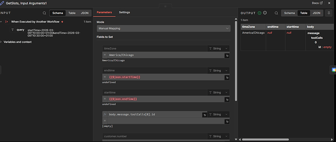

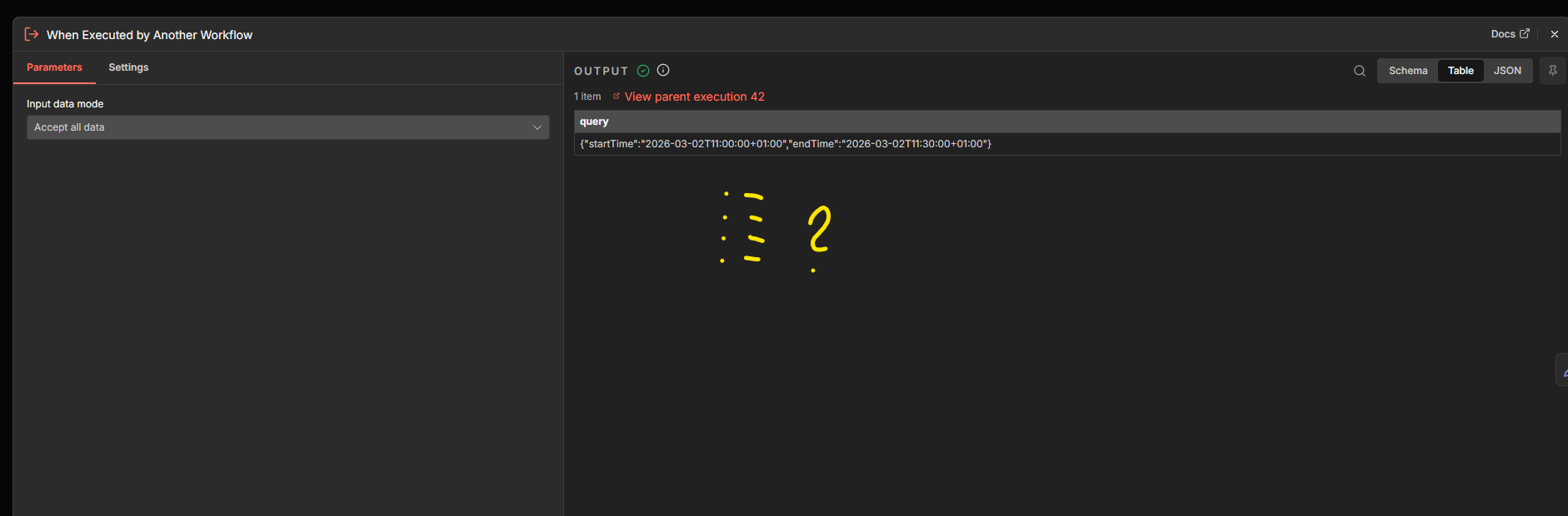

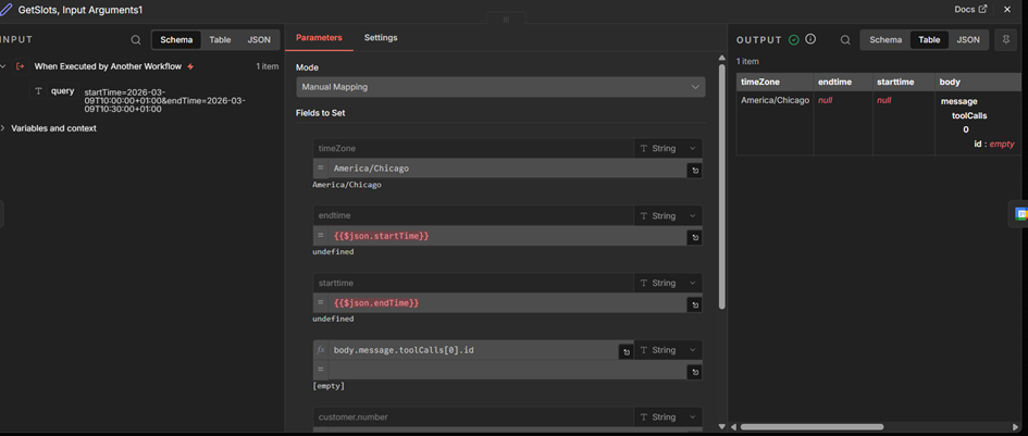

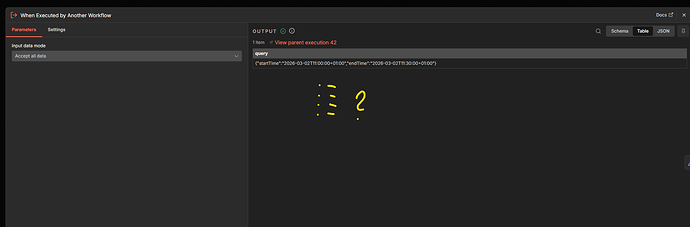

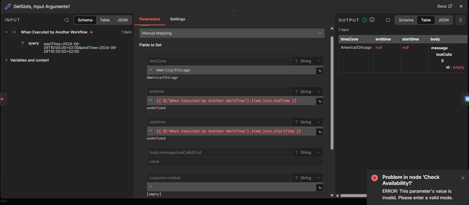

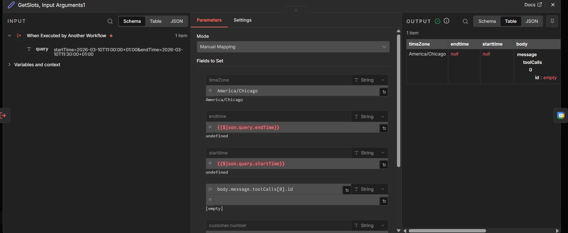

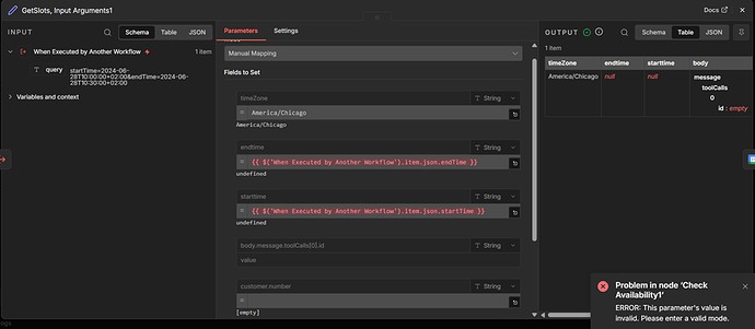

Hello Tamy, that´s a good hint, thanks. Yet, i struggle to get the two values, because the output in the subworkflow is: startTime=2026-03-09T14:00:00+01:00&endTime=2026-03-09T14:30:00+01:00.
Setting up a variablese node is not working with the both kind of formulas I put in the set fields (pictures). I tried also set a code node right after my trigger workflow (“when executed by another workflow”) but it gave nothing out, I try now other variations of code nodes. When I have something new, I tell you here.
@Stefan_Sinz
From your screenshots the sub‑workflow is receiving startTime and endTime in the trigger’s query string, so they live under $json.query, not directly on $json. In the Variables/Set node use {{$json.query.startTime}} and {{$json.query.endTime}}. If you instead pass a JSON body from the parent via Execute/Run Workflow, then they’ll arrive at the child as top‑level fields and you’d use {{$json.startTime}} and {{$json.endTime}}. Don’t try to reference the node name or read tool arguments directly, because the sandbox blocks that; always read from the trigger’s input.

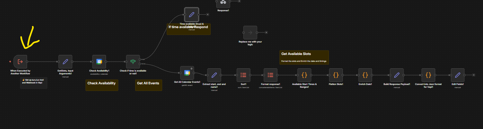

Thanks for the fast reply. It makes absolute sense, as a beginner I did not mention about that. But still, it does want not to work. I really don´t get why.. Do you have some idea..?
@Stefan_Sinz, I’m sorry, I didn’t realize you was using “when exec…”
your parent workflow is sending the parameters as a query string instead of as a proper JSON body.
I would pass the data as structured JSON like startTime and endTime as normal fields, rather than letting them go through as query parameters. Once you do that, inside the sub-workflow you can simply access them with {{$json.startTime}} and {{$json.endTime}} without using .query. This usually makes things much simpler and avoids the undefined problem you’re seeing.

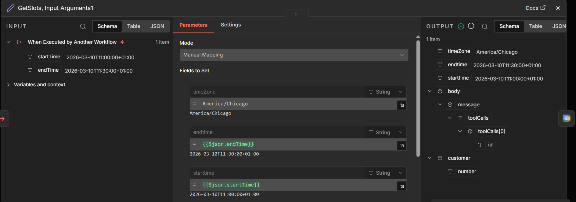

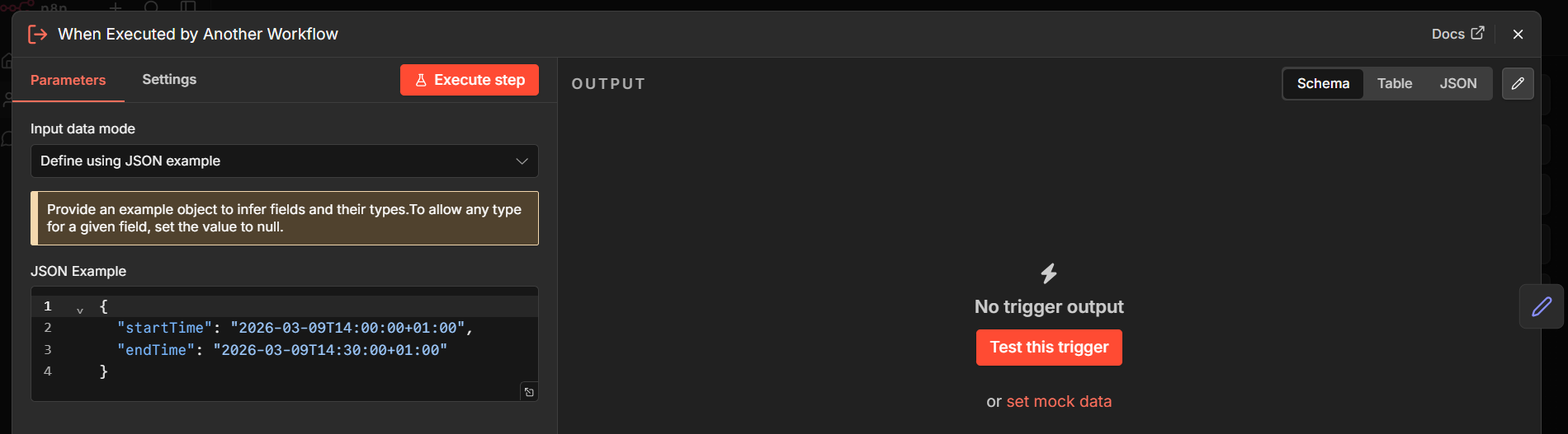

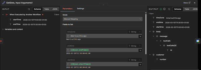

Thanks so much, this was it! This is my Sub workflow (the ai told me I should put an example in for both start-and endtime). Last Picture is the parent workflow, creating the two json parameters artificially. If it looks not like a total disaster for you, then I think I am fine, haha. Thank you again and have a great week.
