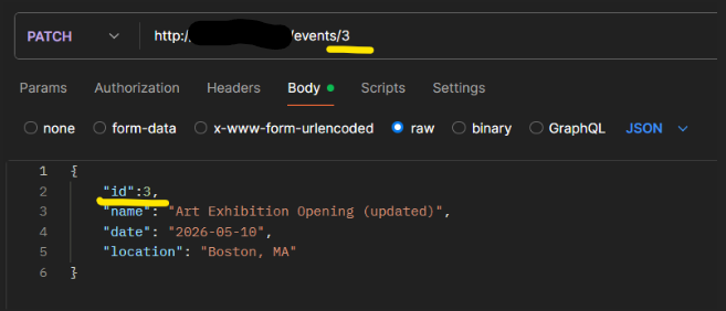

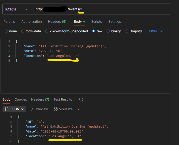

This is a PATCH API call that works when tested in Postman the following 2 ways:
It will work even if you remove the “id” attribute from the JSON body. Here is how that looks:

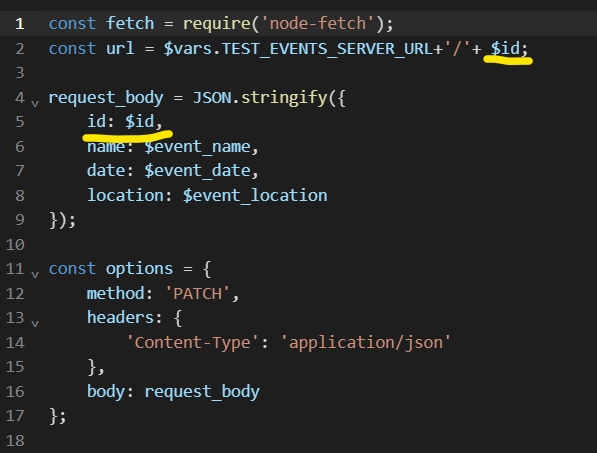

But if I write a tool call using Python of JavaScript based on the second method, the tool call fails with the “schema mismatch error”. Therefore, it is important that "id" attribute be provided in the stringify call. If the “id” is missing, this can be one of the reason’s of a schema mismatch error.

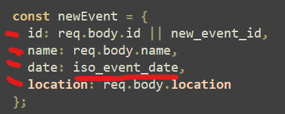

This is easily missed. The Web server expects the following parameters in the request object.
Example:
The server expects id, name, a date in the iso 8601 format and location.
But if the date isn’t passed in the ISO-8601 format, the tool call fails because the API call will fail causing the mismatch error to show in the chat response.
Likewise, on the client side, the parameters must match when making the API call.
This works because the parameter names in the stringify match:
request_body = JSON.stringify({
date: $event_date,
location: $event_location
But this call will cause a tool call to fail with schema mismatch error.
event_name: $event_name,
event_date: $event_date,
event_location: $event_location

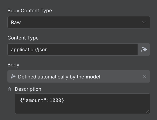

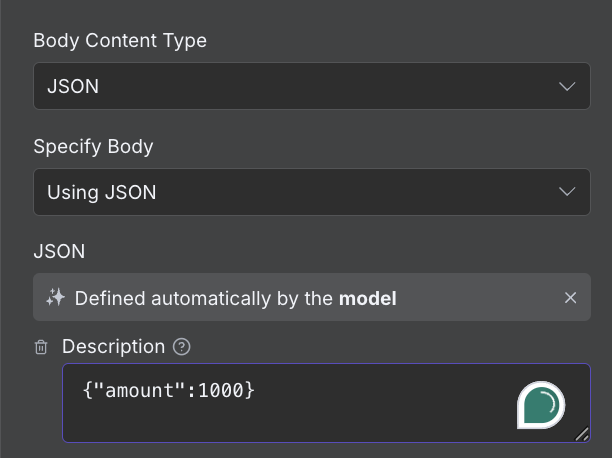

I was able to fix it using a small change in the HTTP Request Tool
This setting would give the error
I changed the ‘Body Content Type’ to ‘Raw’, set ‘Content Type’ to ‘application/json’.
Then, let AI set the ‘Body’ field and put the same description.
This setting fixed the problem.
Looks like an n8n bug where it’s not handling the ‘Body Content Type’ = ‘JSON’.
