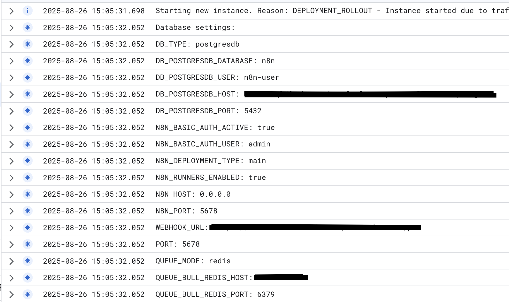

I have the following env vars:
DB_TYPE=postgresdb
DB_POSTGRESDB_HOST=Cloud Sql host
DB_POSTGRESDB_PORT=5432
DB_POSTGRESDB_DATABASE=n8n
DB_POSTGRESDB_USER=n8n-user
EXECUTIONS_MODE=queue
N8N_DEPLOYMENT_TYPE=main
N8N_RUNNERS_ENABLED=true
N8N_BASIC_AUTH_ACTIVE=true
N8N_BASIC_AUTH_USER=user
N8N_BASIC_AUTH_PASSWORD=password
N8N_ENFORCE_SETTINGS_FILE_PERMISSIONS=false
N8N_HOST=0.0.0.0
N8N_PORT=5678
WEBHOOK_URL=https://XXXXXX.europe-west3.run.app
N8N_EDITOR_BASE_URL=https://XXXXXX.europe-west3.run.app
N8N_RUNNER_AUTH_MODE=service
N8N_RUNNER_AUTH_TOKEN=super-secret-token
QUEUE_MODE=redis
QUEUE_BULL_REDIS_HOST=Redis Private IP
QUEUE_BULL_REDIS_PORT=6379
OFFLOAD_MANUAL_EXECUTIONS_TO_WORKERS=true

startup.sh
#!/bin/sh
# Print environment variables for debugging
echo “Database settings:”
echo “DB_TYPE: $DB_TYPE”
echo “DB_POSTGRESDB_DATABASE: $DB_POSTGRESDB_DATABASE”
echo “DB_POSTGRESDB_USER: $DB_POSTGRESDB_USER”
echo “DB_POSTGRESDB_HOST: $DB_POSTGRESDB_HOST”
echo “DB_POSTGRESDB_PORT: $DB_POSTGRESDB_PORT”
echo “N8N_BASIC_AUTH_ACTIVE: $N8N_BASIC_AUTH_ACTIVE”
echo “N8N_BASIC_AUTH_USER: $N8N_BASIC_AUTH_USER”
echo “N8N_DEPLOYMENT_TYPE: $N8N_DEPLOYMENT_TYPE”
echo “N8N_RUNNERS_ENABLED: $N8N_RUNNERS_ENABLED”
echo “N8N_HOST: $N8N_HOST”
echo “N8N_PORT: $N8N_PORT”
echo “WEBHOOK_URL: $WEBHOOK_URL”
echo “PORT: $PORT”
echo “QUEUE_MODE: $QUEUE_MODE”
echo “QUEUE_BULL_REDIS_HOST: $QUEUE_BULL_REDIS_HOST”
echo “QUEUE_BULL_REDIS_PORT: $QUEUE_BULL_REDIS_PORT”

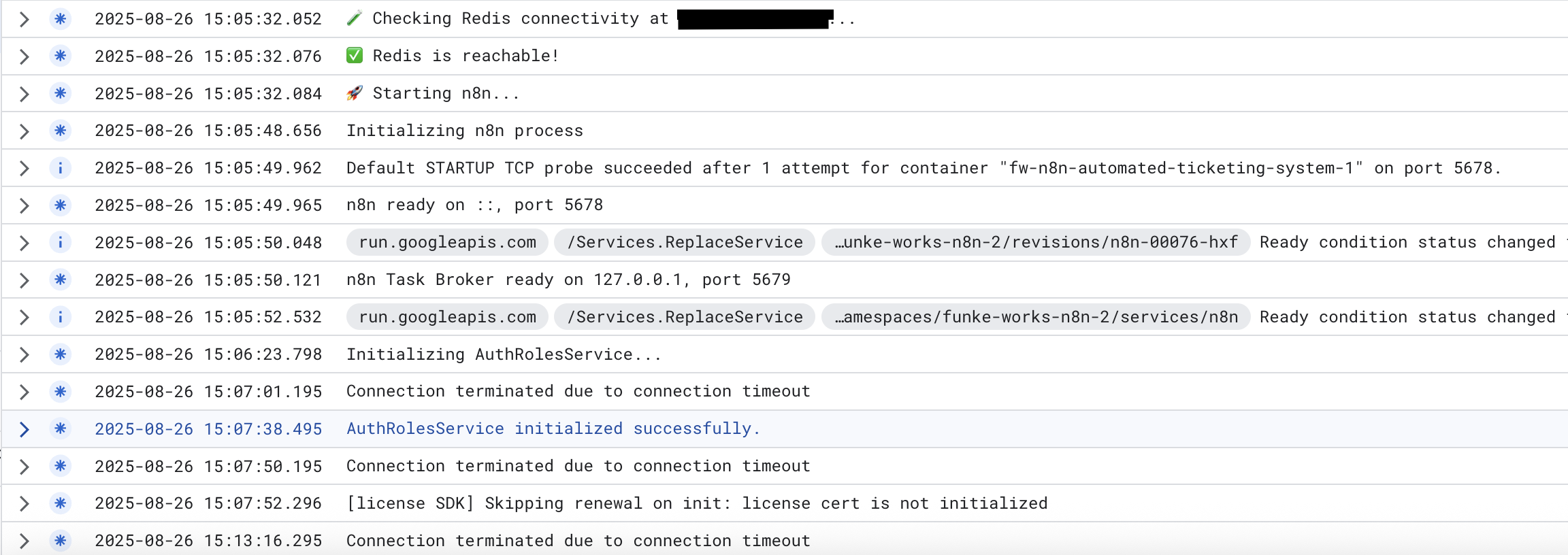

echo “:test_tube: Checking Redis connectivity at $QUEUE_BULL_REDIS_HOST:$QUEUE_BULL_REDIS_PORT…”
# Try to connect to Redis (max 5 attempts)
for i in {1..5}; do
if nc -z “$QUEUE_BULL_REDIS_HOST” “$QUEUE_BULL_REDIS_PORT”; then
echo “:white_check_mark: Redis is reachable!”

# Start n8n
echo “:rocket: Starting n8n…”
# Start n8n with its original entrypoint
exec /docker-entrypoint.sh

I get Cannot GET / in the app endpoint https://XXXXXX.europe-west3.run.app
Env variables seem to be correctly set, but Redis connection times out and it doesn’t seem to use Redis queue based on n8n Task Broker ready on 127.0.0.1, port 5679.
Considerations:
  • Redis is reachable using nc or startup script in a different container.
  • n8n fails to maintain connection to Redis.
  • I’ve tried to use .n8n/settings.js to force config (copied into Docker image at /home/node/.n8n/settings.js) and changed to N8N_ENFORCE_SETTINGS_FILE_PERMISSIONS=true, but it didn’t work either.
  • I’ve set N8N_RUNNERS_BROKER_LISTEN_ADDRESS=0.0.0.0 in main instance, but it didn’t change anything.
  • n8n version: 1.103.2

I have the same issue. I’m running on en AWS ECS and using ElastiCache for Redis.
The server takes a considerable amount of time to spin up and I realized that the min_instance of my Cloud Run service was set to 0. Therefore, every time that I wanted to access the it, it had a cold start and I would get that message. My problem was solved when I set min_instance to 1.
