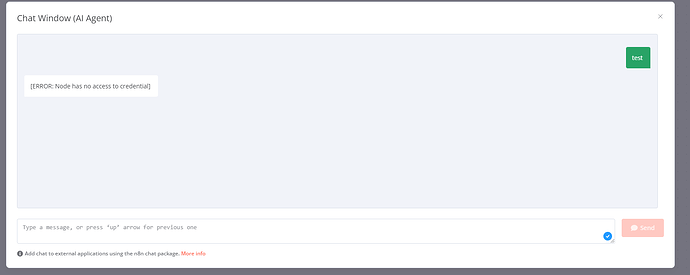

We are using DigitalOcean for Redis, already found out that on DO we need to disable TLS to make N8N work , so developer has disabled it already.
When saving credentials without SSL it will keep spinning and doesnt save at all. When we enable SSL, it will save, but we will get this error when using the DB.

The “Node has no access to credential” error you’re seeing suggests that a node in a workflow tried to access a credential that it does not have permission to use - are you the owner of the credential or is it from another team member?

What you’re seeing here is n8n not being able to successfully connect to Redis which is expected.
But the [Error: Node has no access to credential] suggests that you’ve managed to connect Redis to n8n but it’s trying to access a credential that it does not have permission to use. Were you the one who created the credential? Could you try recreating a new credential again?
When we disable SSL in n8n, it gives error.
If we use SSL its connecting and gives succesfull connected message, so the credentials are working?
Just tested with this module, and Redis seems to work with SSL enabled in the connecton.
Only when using the Redis Memory in the AI Agent it gives error?
