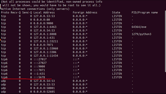

Ok, so we now know that accessing ollama from n8n container is possible, we were able to reach it through port 11434 and see see it listening on port 11434 in the netstat output.

I would expect it to fail as 127.0.0.1 is local to the container not the host and as the services are not running in the container it won’t be listening.
Try using something like 172.17.0.1 or the ip of the host / container running.
but n8n container is bound to the host network, exposing it to the host netw stack.
this is confirmed with docker inspect and also through running curl http://127.0.0.1:11434 from the container itself.

The netstat command also wasn’t showing n8n running so maybe we should confirm the command was launched in the n8n container.

There is no output in host terminal neither inside bash n8n

The solution to this case is running Ollama on Docker.

That would most definitely help, as well as not running containers bound to the host network.
