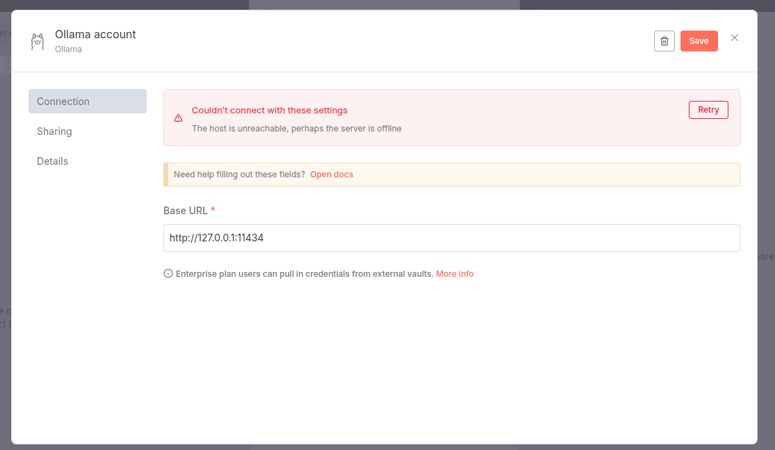

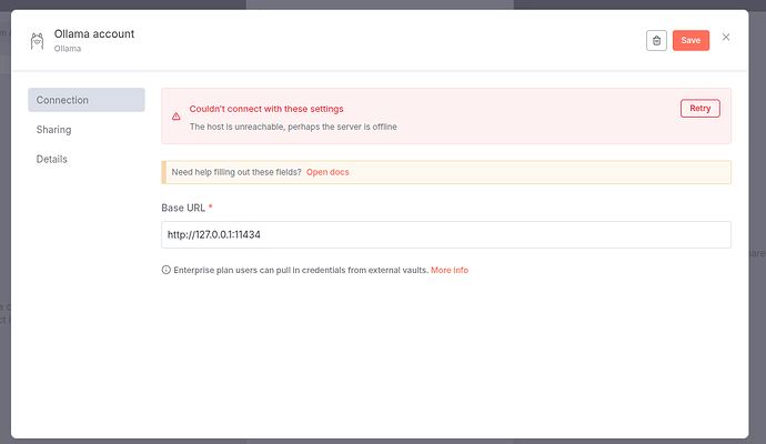

Well it is listening, so when you try to create ollama credentials in n8n using this IP and port what error do you get? I think you only mentioned Mongo previously
The host is unreachable, perhaps the server is offline

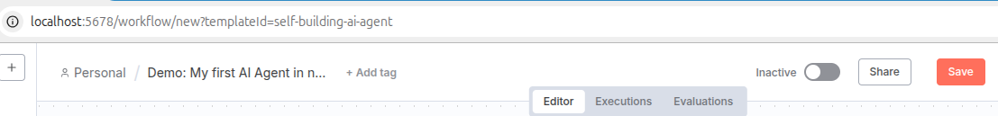

Can you show a screenshot of a browser window with n8n, where you try to create credentials for ollama?
And you are sure you are running only a single instance of n8n, no second n8n, or cloud, does your browser URL start with http://127.0.0.1:5678?
I am sure,

  • an attempt to create credentials in n8n for ollama and pointing it to 127.0.0.1:11434 results in The host is unreachable, perhaps the server is offline error
Next I would try to connect to the n8n docker container and see what we can reach from there. Before we go there, another thing that we could try:
http://127.0.0.1;11434 to http://localhost:11434 result:

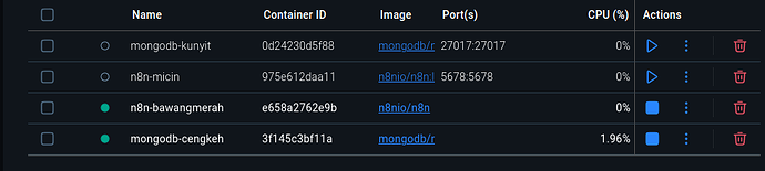

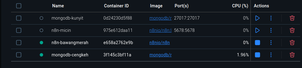

docker -ps -a
CONTAINER ID IMAGE COMMAND CREATED STATUS PORTS NAMES
3f145c3bf11a mongodb/mongodb-atlas-local “/usr/local/bin/runn…” 2 hours ago Up 2 hours (healthy) mongodb-cengkeh
e658a2762e9b n8nio/n8n “tini – /docker-ent…” 3 hours ago Up 2 hours n8n-bawangmerah
0d24230d5f88 mongodb/mongodb-atlas-local:latest “/usr/local/bin/runn…” 10 days ago Exited (2) 24 hours ago mongodb-kunyit
975e612daa11 n8nio/n8n:latest “tini – /docker-ent…” 10 days ago Exited (0) 24 hours ago n8n-micin

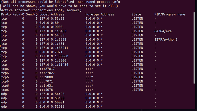

now try to run the same curl command we did earlier:
curl http://127.0.0.1:11434
also run
netstat -tulnp
and show me what you got.
Ollama is running
netstat -tulnp
