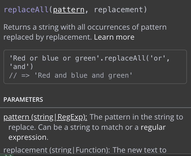

For future, you could also utilize the built-in replace/replaceAll function together with some regex to help with string cleanups in your expressions.
I’ll avoid anything related to regex as long as I can, but it’s a cool idea. Thank you for that :pray:!
