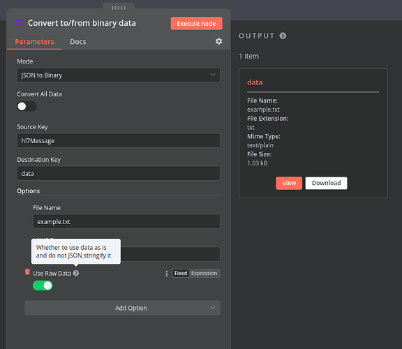

Hi @Trolland, welcome to the community!
Are you looking to just write the string from your hl7Message field into a file, without anything else (especially no quotes)? If so, you’re probably looking for the “Use Raw Data” option.
Here’s a quick example workflow:
The result would not include any quotes around the string.
Hope this helps! If that’s not it, perhaps you can confirm how you want your result file to look like?
