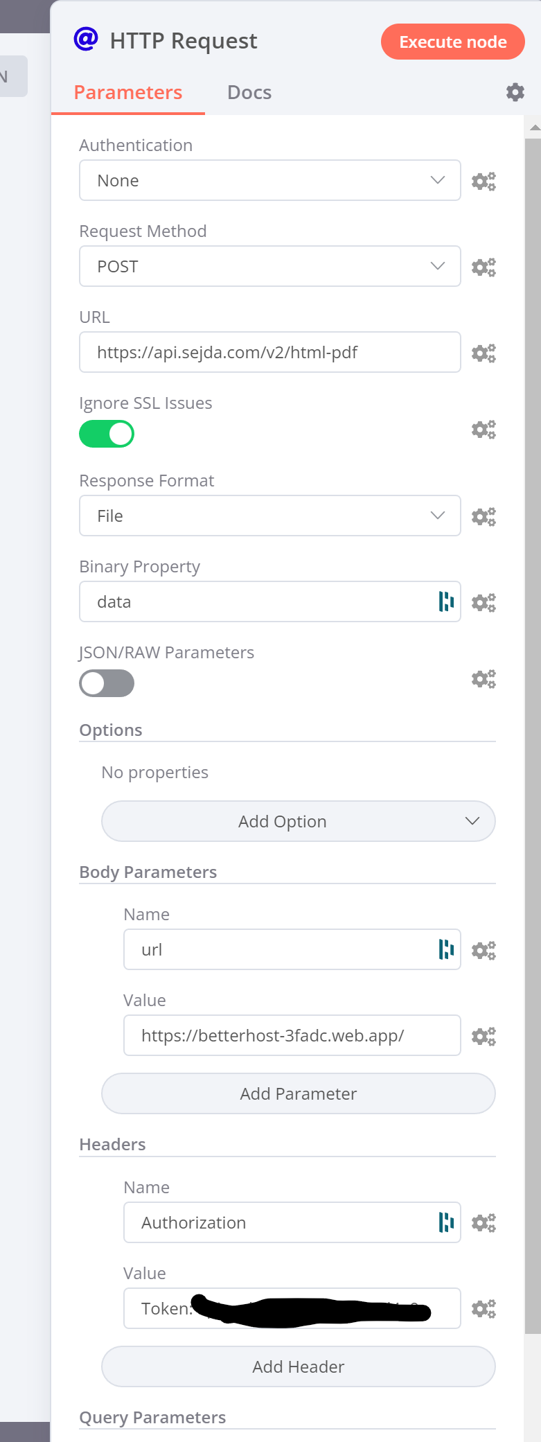

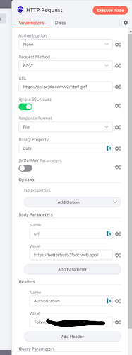

When I run the log next to it I get this error again, it runs in a loop. In fact it is completely random the errors. And they are caused by this node.

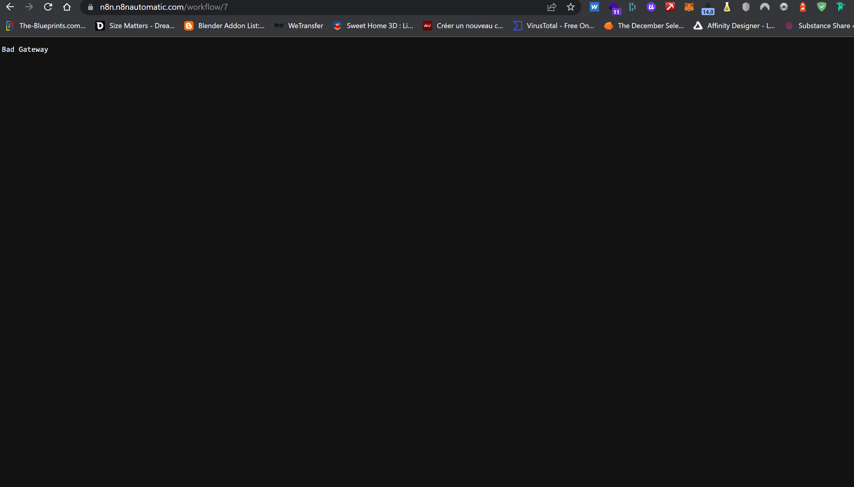

I have the impression that the error message is only on the ui interface. The console log did not show any error

I can spot another issue in your workflow though which could contribute to the problem. The HTTP Request node isn’t connected to any incoming node which was never intentionally supported and just worked by accident.
Can you confirm if your request works in a separate workflow where the input of the HTTP Request node is connected to another node?
