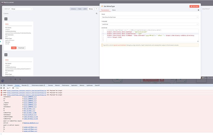

I am querying API, which returns a PDF. However, the API is not correct as it returns mime type application/json.
To fix that, I am using a custom code.
413 would mean that the generated JSON for the workflow that gets sent to /rest/workflow/run is larger than 16MB.
Do you have env variable N8N_DEFAULT_BINARY_DATA_MODE set to filesystem? if not, I’d recommend trying that.
