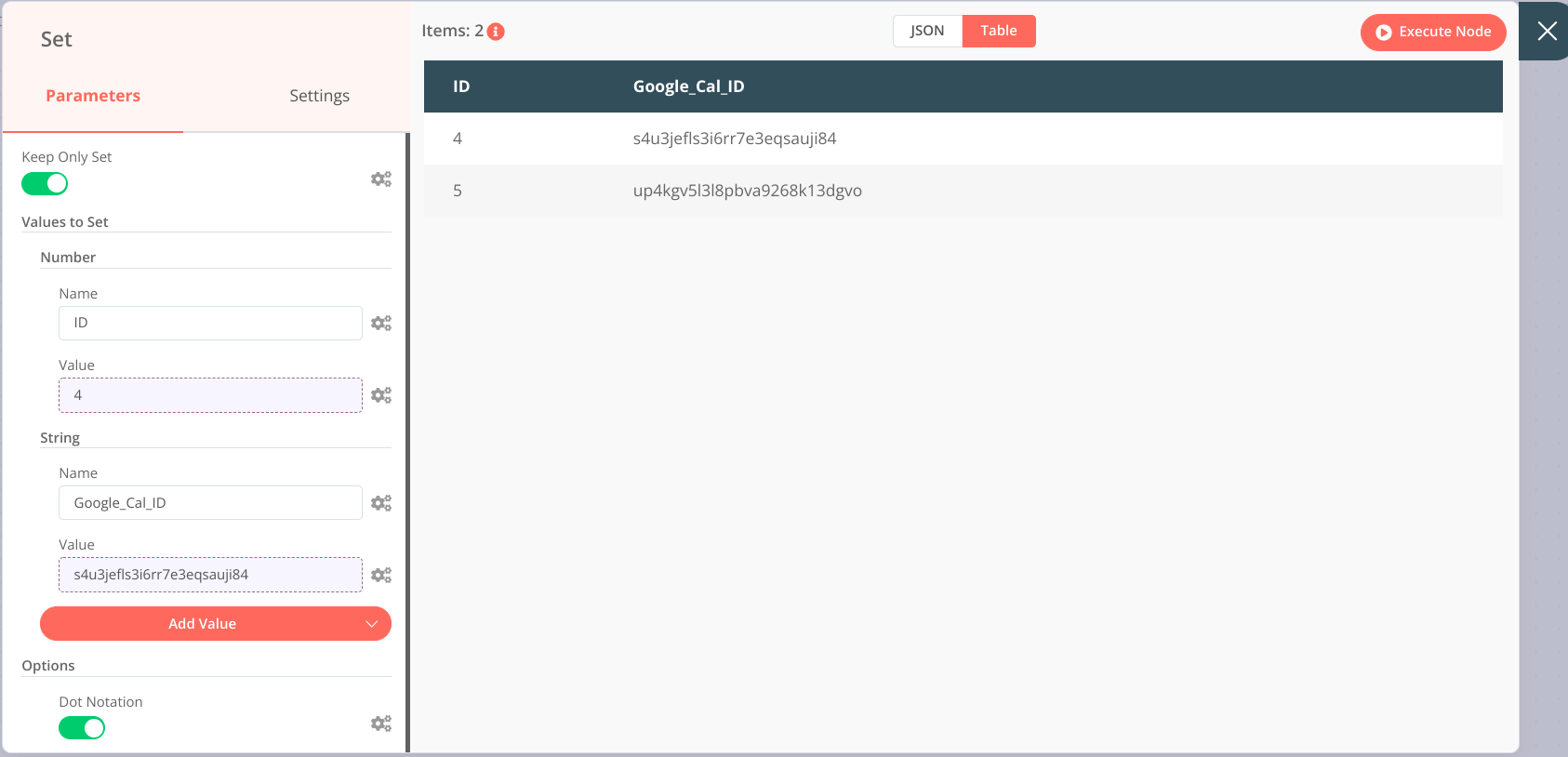

All good. I figured it out. Had to write the values from Google Calendar events to a “Set” node first, with variables that have the same name as the columns in the MSSQL table.
I was also surprised to find that I had to write the values from specifying the exact Node, not from the passed values to the “Current Node”. The “Current Node” values just returned as blank values in when executing the node after building the result in the Expression builder, even though the value was shown in the result in the expression builder.
