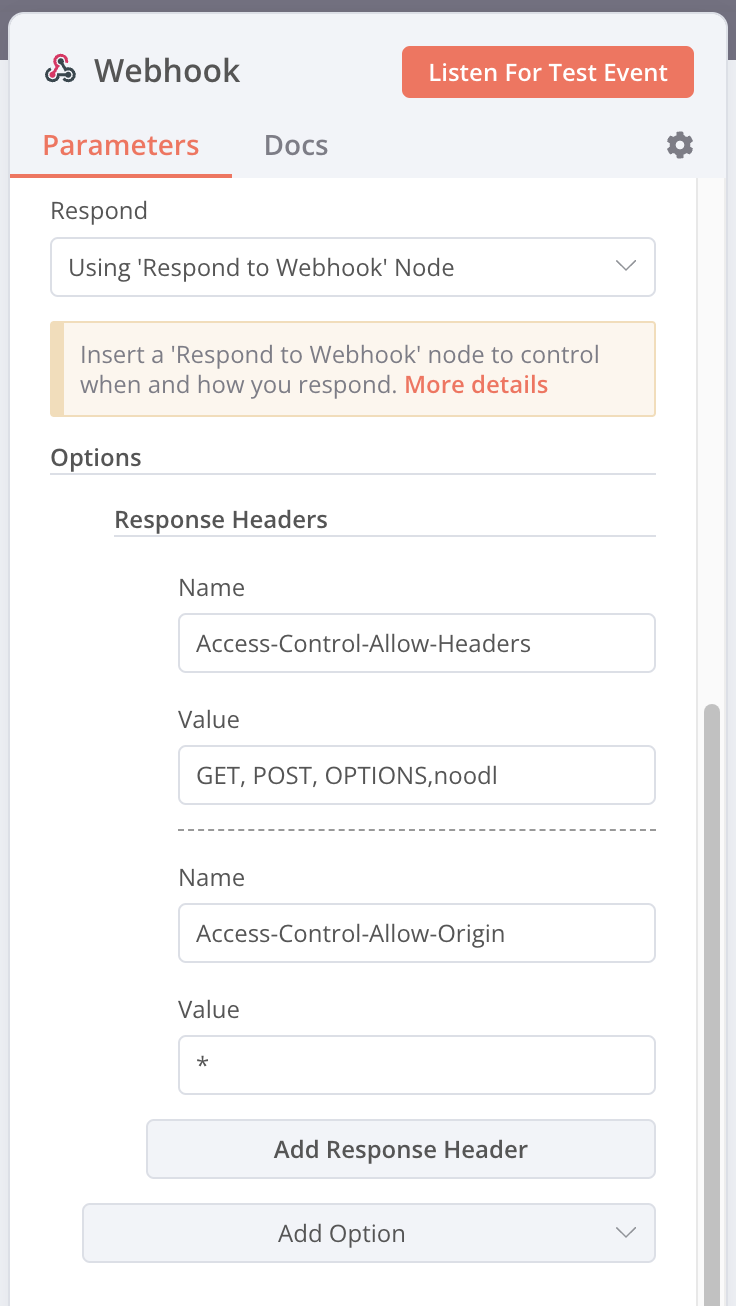

Thanks @ria!
I am indeed using a webhook node and using n8n 1.4.0. However I do not see ‘Allowed Origins CORS’ available to me. Sharing a screenshot of what I do see along with some of my configurations. Thanks for your support!

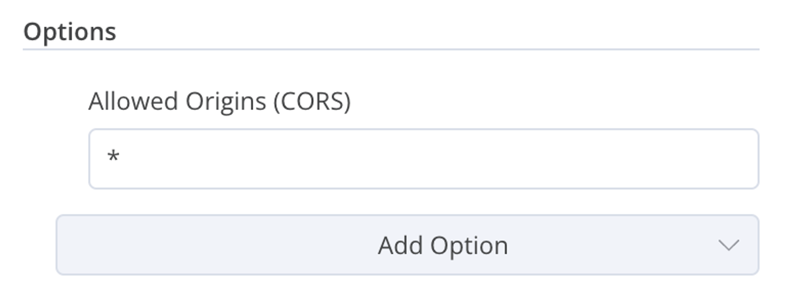

Updating the the latest n8n made that CORS setting available. Everything works after enabling it. Thanks!!
