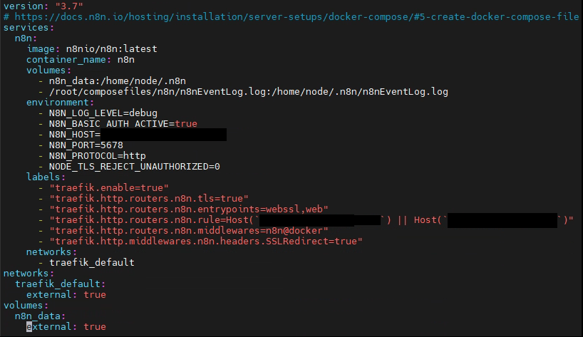

  • n8n version: 1.69.2
  • Running n8n via (Docker, npm, n8n cloud, desktop app): docker compose (configuration file below)
  • Operating system: RH9.4
    Docker compose file:
