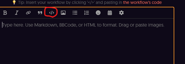

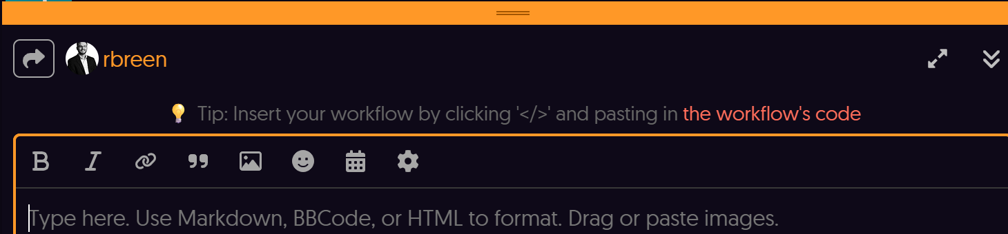

Can you paste that workflow into a code block so it renders and I can copy it?
Might I ask how i can share my workflow using block code.
copy your workflow from n8n, and paste it in the code block here. Here’s an image.
Thanks for the clarification. I think something is wrong with my account since i dont have the same options as you.
