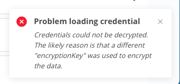

After upgrading to version 1, the instance replaced encryptionKey by itself for some reason.
I think it’s clear that no workflows work, but that’s not the problem anymore - I can’t export them, I get an error:
Credentials could not be decrypted. The likely reason is that a different "encryptionKey" was used to encrypt the data

Hi @brewoutlay ,
If you do not have the encryption key you can not restore the credentials. You will need to enter them all again.
Personally, I always set an encryption key in the env variables to make sure it keeps the same key at all times.

Hey @brewoutlay,
The n8n application will only create an encryption key if an existing one can’t be found. The key itself will normally be in the .n8n folder that would be mapped to a docker volume or bind, If however this was not correctly configured the key would only exist for as long as the instance is on the same version.
If the original encrypted key is lost there is no way to recover the credentials as they are encrypted with a random key generated just for your instance so you would need to create the credential again.
