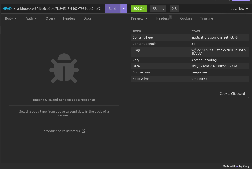

Hi @StocktonF, I am sorry to hear you’re having trouble.
I just tried this on my end, but am getting a 200 status as expected:
The request also shows up in n8n as expected when using the test URL:
Which response exactly are you seeing in Postman? Were you perhaps simply not manually executing the workflow (when using the test URL) or didn’t activate your workflow (when using the production URL)?
