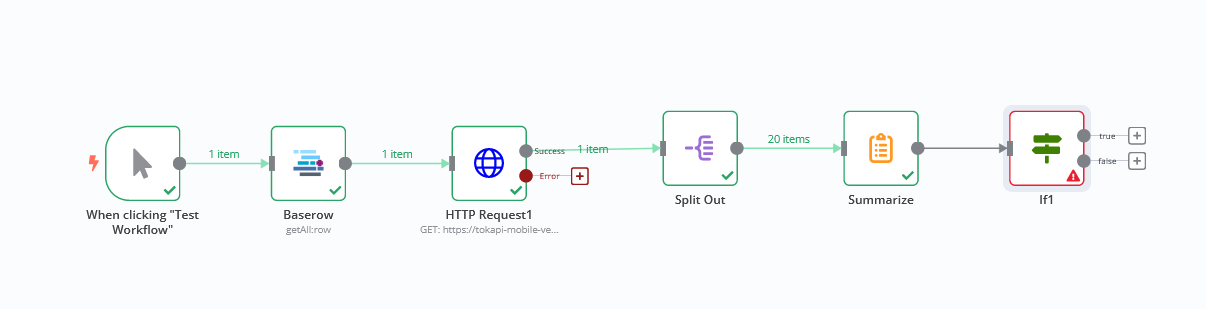

I’m trying to get the average of x Items, then us the if node to compare if each item is greater than 5x the total average.
Here is the current workflow
this doesn’t work because the summarize node only outputs the average as 1 item, I also need the 20 items from the split out node to compare them to the average.
Using the merge node to append the items and to output 21 items doesn’t work, gives null for the calculated average.

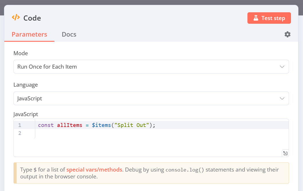

and using this in the code node gives the following error.
tldr: Summarize node outputs 1 item, I want it to output 21 items so that I can compare them to each other usisng the IF node.

Im running the latest version of n8n on cloudron. Unfortunately I cant share the data but I dont think that matters here. Ive seen here
that this function
const allItems = $items("Filter Tasks");
should output all the items in the split out node but it returns this error instead
ERROR: Code doesn't return an object [item 0]
Please return an object representing the output item. ('undefined' was returned instead.)
Hi @Trash :wave: We only ask for sample data to make it a little easier to reproduce the issue :sweat_smile: You could do something like return allItems = $('Filter Tasks').all(), as the syntax has changed after version 1 :+1:

Thank you so much. the code snippet you provided worked. I tried using the merge node before but it didn’t work.
