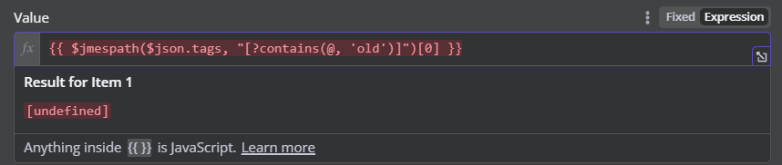

Firstly, sorry for the delay in responding.
Regarding your answer, thank you, that’s exactly what I needed, however, I have a problem. When there is no result it is returned as “undefined”, is it possible to handle this? that is, if it doesn’t find any results, does it return a default value?
{{ $jmespath($json.tags, “[?contains(@, ‘cat’)]”)[0] ?? ‘default_value’ }}
