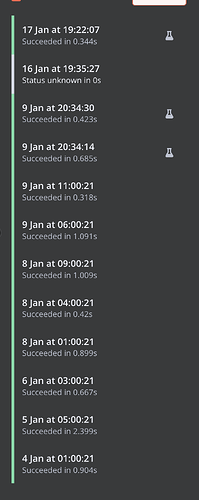

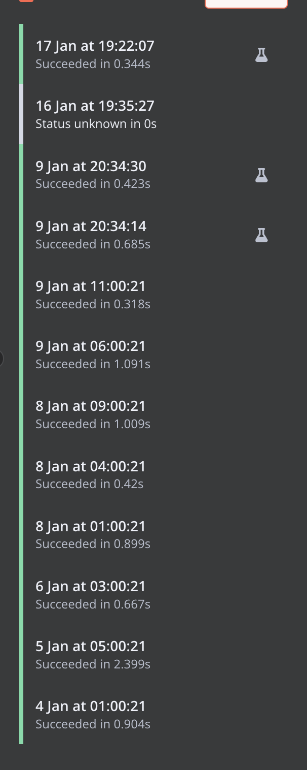

It’s configured to run every hour when I re set it up with the built in RSS Feed Trigger but as you can see, it’s very sporradic, then it didn’t run since the 9th. Yesterday was update night, so that would be why it tried to trigger again, then after logging in tonight I had it test execute, and it worked (And subsequently spammed by slack channel with all the backlogged articles.)
