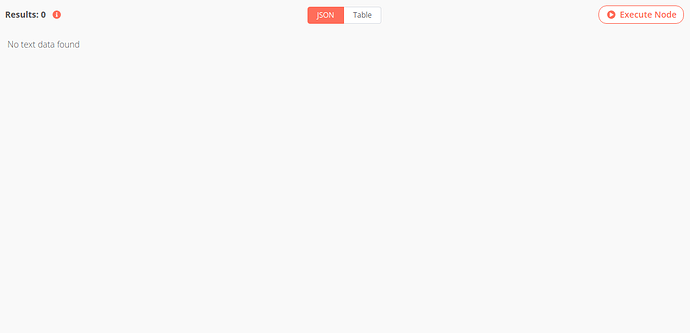

I press button “Execute node”, it loads too long. After that, it has result like this image.
Very strange. Have never seen that before. If it executes but does not have a result it should look like this:

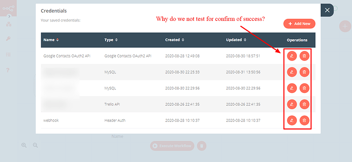

But why do we not test for confirmation of credential’s success, or we have a “test button” to khow what of cause exactly?
Normally, when credential added, its port is ok
Firewall issue is problem of credential, I think, in stead of node issues.
It seems credentials added and tested.

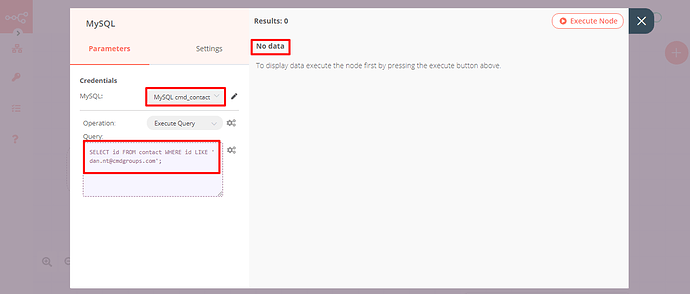

Well, when I take off route from MySQL node, it run and show this error:
(I think connection make this error can’t display)
ERROR: You have an error in your SQL syntax; check the manual that corresponds to your MariaDB server version for the right syntax to use near ‘SELECT id FROM contact WHERE id LIKE ‘dan.nt@cmdgroups.com’’ at line 1
Do you have any idea?
Error: You have an error in your SQL syntax; check the manual that corresponds to your MariaDB server version for the right syntax to use near 'SELECT id FROM contact WHERE id LIKE 'dan.nt@cmdgroups.com'' at line 1

Why we do not test if the credentials are valid and a connection with them is possible? Very simply because it has not been programmed. There are probably a million things like this that could be added to n8n but somebody has to program them. As we do not have unlimited resources and additionally have to split our time between answering questions in the community like this and writing code, do we have to prioritize which features are more important than others. If you think that this is something that really has to exist in n8n we would be more than happy to merge a pull-request once you created it.

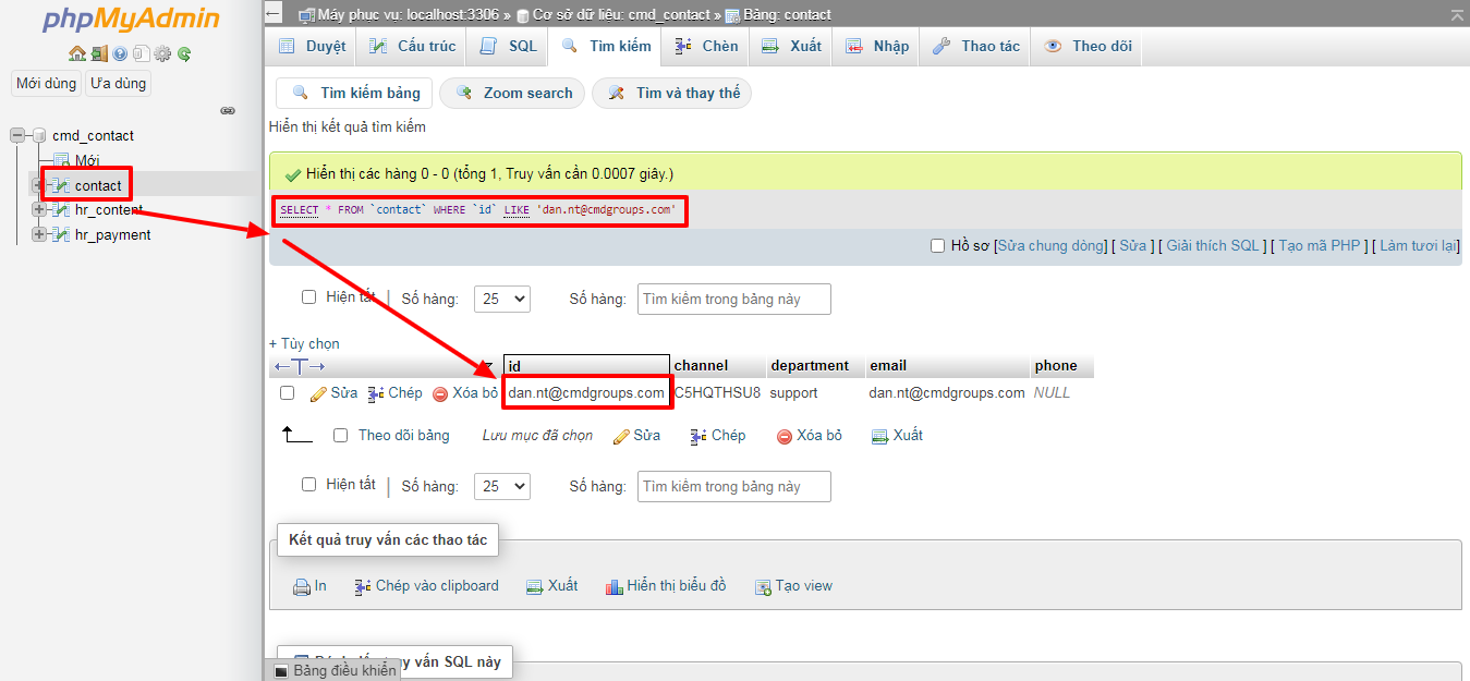

About the issue, you are having now. Do sadly not have the slightest idea. Looks correct for me. To be 100% sure I did test a similar request locally with MySQL where it worked fine. So maybe there is really a difference in recent MariaDB versions.

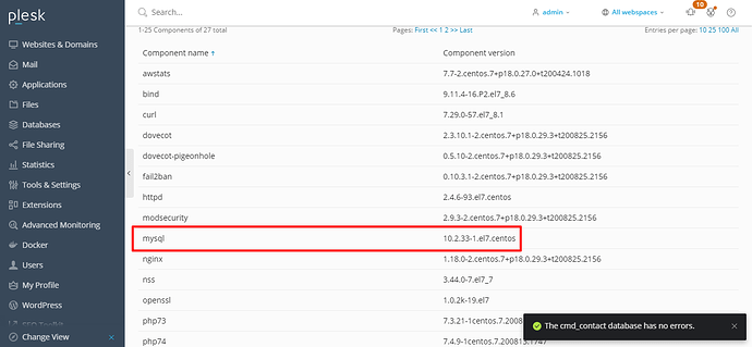

Well, I upgraded mysql to version 10.1 (the lastest of plesk supported)
But connection still failed. I have a big issue of mysql connection.

I tried earlier today with version 8 as it seems to be the latest stable version.
Plesk can’t support v8. All my data 's in plesk now (last notice)
I have a big issue…
In this case, I doubt that you have MySQL 10 installed if they do not even support 8 yet. (not even sure v10 exists already).
I guess what it displays there is some kind of module and not the actual MySQL version.
