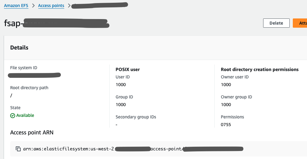

I created an AWS ECS Service on Fargate using n8n docker hub image ‘n8nio/n8n:latest’. The service uses EFS with access point that mounts to ‘/home/node/.n8n’. The EFS access point’s uid and gid is set to 1000:1000 and permission 0755. The VPC security groups allow the EFS traffic. The EFS system policy is set to allow “elasticfilesystem:ClientRootAccess”, “elasticfilesystem:ClientWrite”, “elasticfilesystem:ClientMount”. But I couldn’t start up the service successfully on ECS Fargate due to some directory access issue. Any help is appreciated.

I can’t access the container as the ECS service cannot start up properly. The task was deprovisioned before it reached the running state. Here’s the volume details of the task definition and EFS access point config. Do you see any problems?

Hi,
Before I tried 0777, I noticed a config file was created under ‘/home/node/.n8n’. And the config file has ‘-rw-r–r–. 1 1000 1000 56 Apr 4 05:55 config’. Then I created a new access point with 1000:1000 and 0777 and tried to redeploy and launch the service on Fargate, the container exit with code 1. And there’s no CloudWatch log any more. What else can I try?
Regards,
PH
