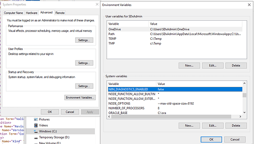

Hi, had checked my system and the .n8n folder exists only my userprofile and not under systemprofile. I didn’t define any environment variable in nssm, but you may try to set it as system variable, as I’d set any n8n env variable there.
If that doesn’t worked, another option is to run n8n using cli then export both the workflows and credentials. After that start n8n as service and import them back in. Do note your workflow number may changed.

Did you try setting N8N_USER_FOLDER and pointing it to the .n8n folder in the users home folder or if you are running as a Windows service with a named user you could run the cmd prompt as that user to do the import. If you are using local system you will have some issues.
