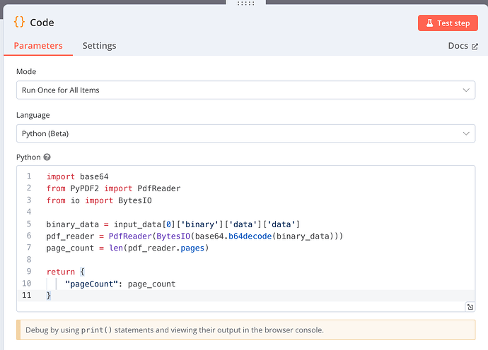

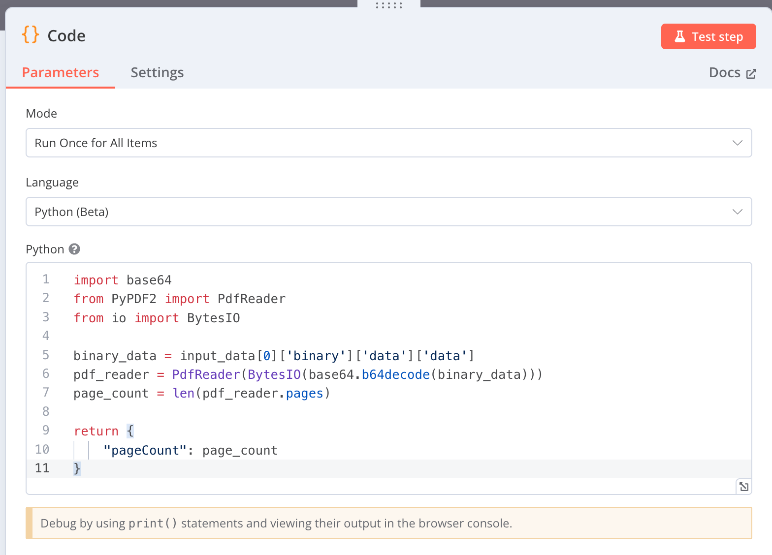

Hey,
I would like to know how you guys install modules to a server to run Python code.
Tried to install module globally, but no luck .
My script looks like:

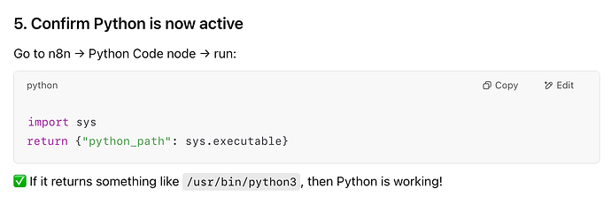

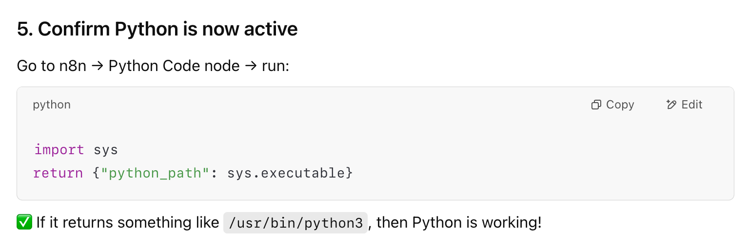

GPT says, that Python path might be wrong:
In my case its:
/usr/lib/node_modules/pm2/lib/ProcessContainerFork.js

Well, it’s easy to run Python in the terminal. It simply works, even with the same modules. Everything is okay, but when I start running Python from n8n, it cannot be found, and I try to find a reason.

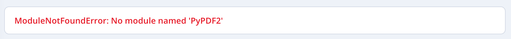

Well, i actually tried this, and it does not work from the terminal… It cannot find the library
apk update&&apk add py3-pypdf
the only import that works from the command-line is from pypdf import PdfReader
if you run execute command node ‘python3 <testscript.py>’ it works as well.
But the thing is that I don’t want to store the Python file on the server - I want it to be stored and launched from n8n. I don’t have issues running Python files from the terminal, but I would like to know if I can run it directly from n8n. I assume that n8n simply doesn’t get the correct path to Python.
