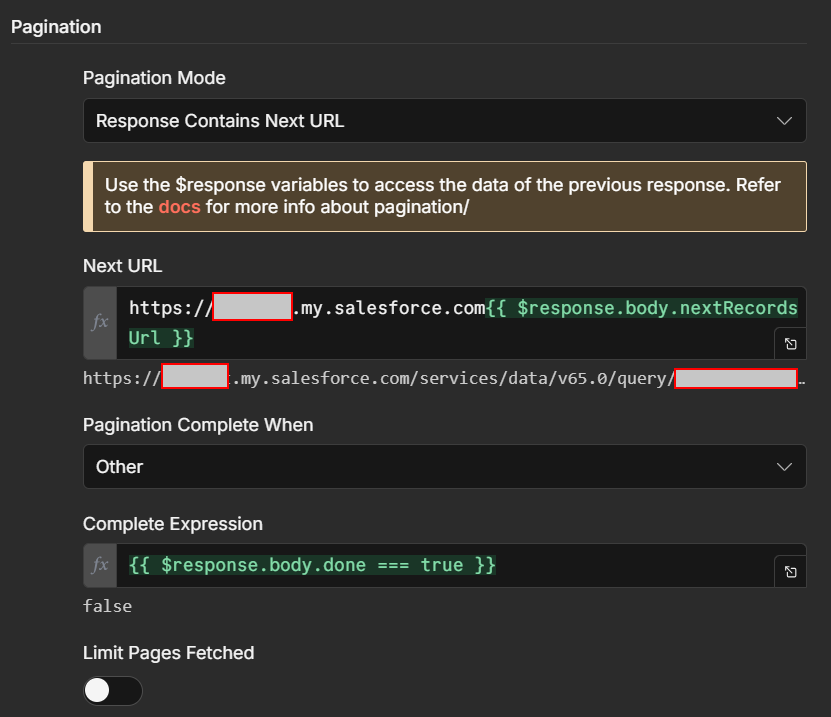

  • I tried to use the HTTP Request node and despite I’m able to get the first batch of records, I’m not able to configure the pagination as it does not seems to work.
There’s no error message but the node loops without ending.
There’s my pagination configuration of the HTTP Request node :
Thanks for your help.

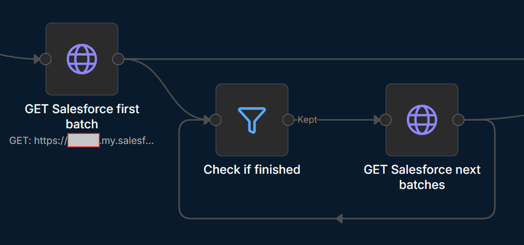

Thanks @niche_slanger_00 for your feedback.
I don’t think that it is the issue because in the meantime, I’ve build manually the loop and it works :
Salesforce have a limit of 2000 records per batch and provide the URL for the next batch of records on the result. The result also return a boolean to check if all pages were processed.

Do you see in “Next URL” you have https://…..
even when “the force” returns no next urls because done = true, you will have a url in the next url. You need to use a expression like this:
{{ $response.body.nextRecordsUrl ? https://YOUR_INSTANCE.my.salesforce.com${$response.body.nextRecordsUrl} : ‘’ }}
Does not seems to work, n8n says “invalid syntax”.
Toss it in ai and try a few different options until you get it right, but that is the premise of how to fix it. You need to say if there’s no next URL don’t show any URL.
