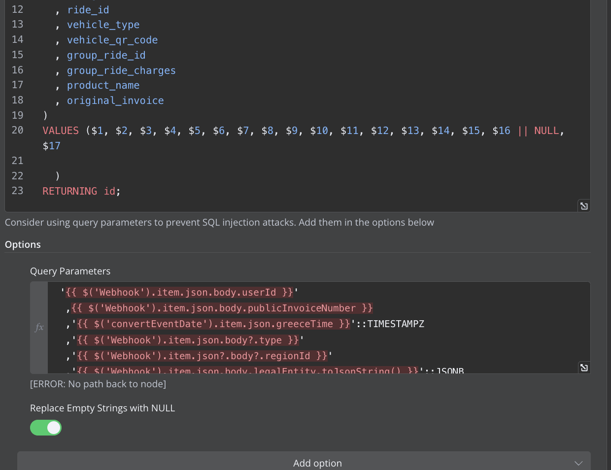

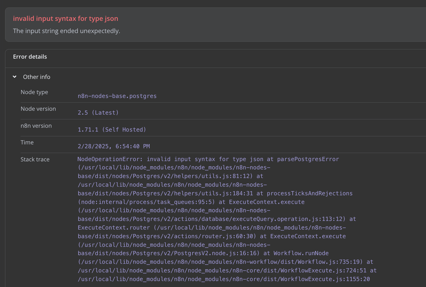

I’m trying to insert a JSONB into my database, which works correctly with the syntax below. However when I try to use the sanitized syntax using $1 it returns error invalid JSON:

How did the sanitized syntax look?
Like this:
Also the toggle “replace empty strings with NULL” was not working as expected
I suppose you can’t use type definitions ( :: ) in the Query Parameters.
Try to set them on the variables instead, e.g. $10::TIMESTAMPZ
