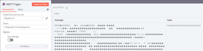

A lot of the bytes that should be 0 have been replaced with spaces. I’m assuming n8n tries to convert the binary MQTT message into text and removes everything that is not valid UTF-8?

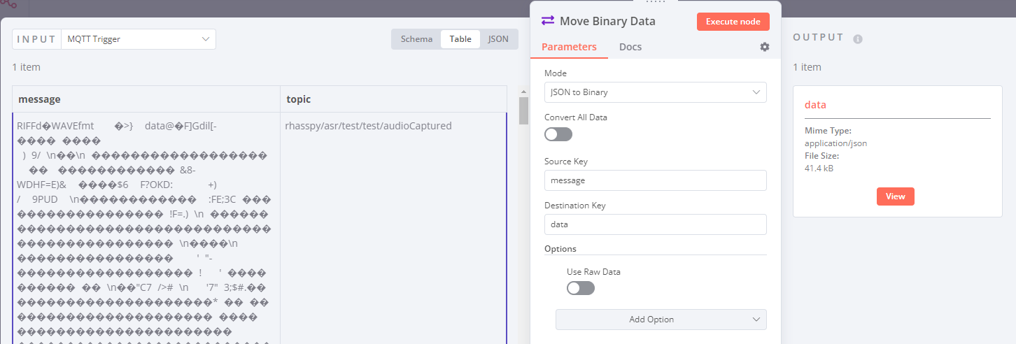

So I enabled the “Only message” options of the MQTT trigger and now I’m getting this:
I’m not too familiar (at all) with MQTT - but could you provide the JSON data from the MQTT trigger? To make sure you’re copying the actual data structure from n8n’s JSON view, you can do so by selecting the first line, then clicking the Copy button and selecting “Copy Selection”. That looks like this:
