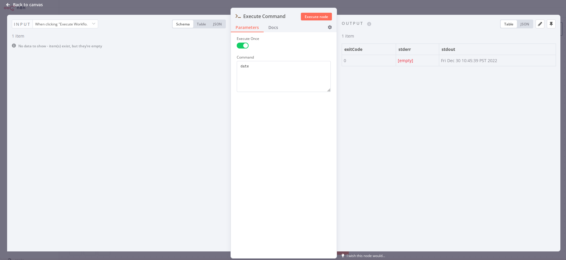

Hey @MutedJam - it gets weirder.
I ran the date command using the Execute Command node - the date here is correct.
So I don’t think this is a server-side issue.
