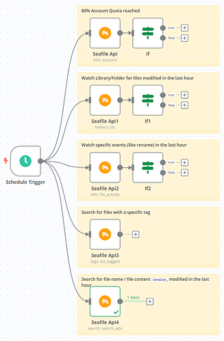

This is my first draft of an actual workflow with the seafile node.
It downloads all files from a dir with a csv suffix and adds the data to a seatable table.

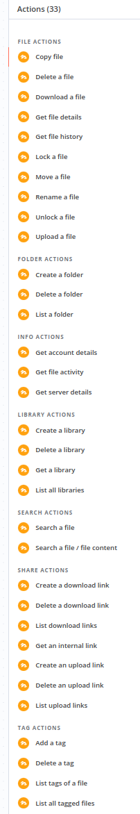

Hey everybody,
33 actions with this new version
I updated/rebuilt the seafile community node for n8n, and now it has in total 33 actions. It should provide you all the necessary functions to interact with your seafile server.
A lot of possible triggers
With the new actions, there are plenty of possible triggers possible. Here are my favored ones:
  • 80% account quota reached
  • Watch Library/Folder for files modified in the last hour
  • Watch specific events (like rename) in the last hour
  • Search for files with a specific tag
  • Search for file name / file content invoice, modified in the last hour
I added only a screenshot because workflow previews does not work with community nodes.
