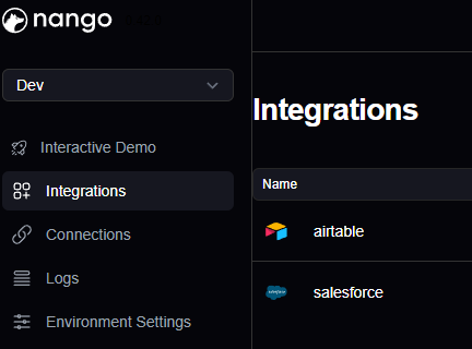

UPDATE: Nango is looking promising here. If you use it for auth only (which is free), your users can authorize their services in your frontend via oauth, api keys or basic auth. Your app can then get and send the related tokens to n8n via webhooks. From there, you may not even need a credential as you can use the HTTP Request node and it’s expressions to dynamically query an API. Or you could query the data and then send it into n8n for processing to not transmit auth tokens. Anyways, it seems like this might be a viable service for handling the original question of this thread.
Curious to see how this develops. I have a couple of clients that want me to build more and more workflows that mainly need a lot of Google account credentials. I also want to build more of an application backend on n8n in the near future that users can sign up to, fill in some variables and get hooked up to a new, corresponding workflow.

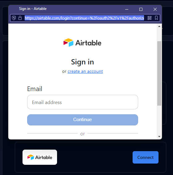

Here’s where I’m at so far:
  1. Users register and sign in to my app
  2. Inside Nango (and in the 3rd party services) I configure integrations
  3. My app uses Nango’s SDKs to generate a list of available integrations and enables users to create and delete connections
  4. Users are prompted to authorize the app, which is slightly different for each service. This creates a ‘Connection’ in Nango
  5. My app then polls Nango for any connections, which include the tokens and URLs necessary to make an API call via the HTTP Request node. They look like:

  1. My app sends webhooks to n8n that contain the connection and any data I want to process in my workflows.
My understanding is that Nango will keep the tokens alive by refreshing them so long as I query them often enough, so the user authorizes just once and only reconnects if credentials change. I also haven’t yet dug into webhook security and reliability for passing credentials, but will do. It’s coming together and I haven’t yet hit a wall that will prevent this from working… :crossed_fingers:
