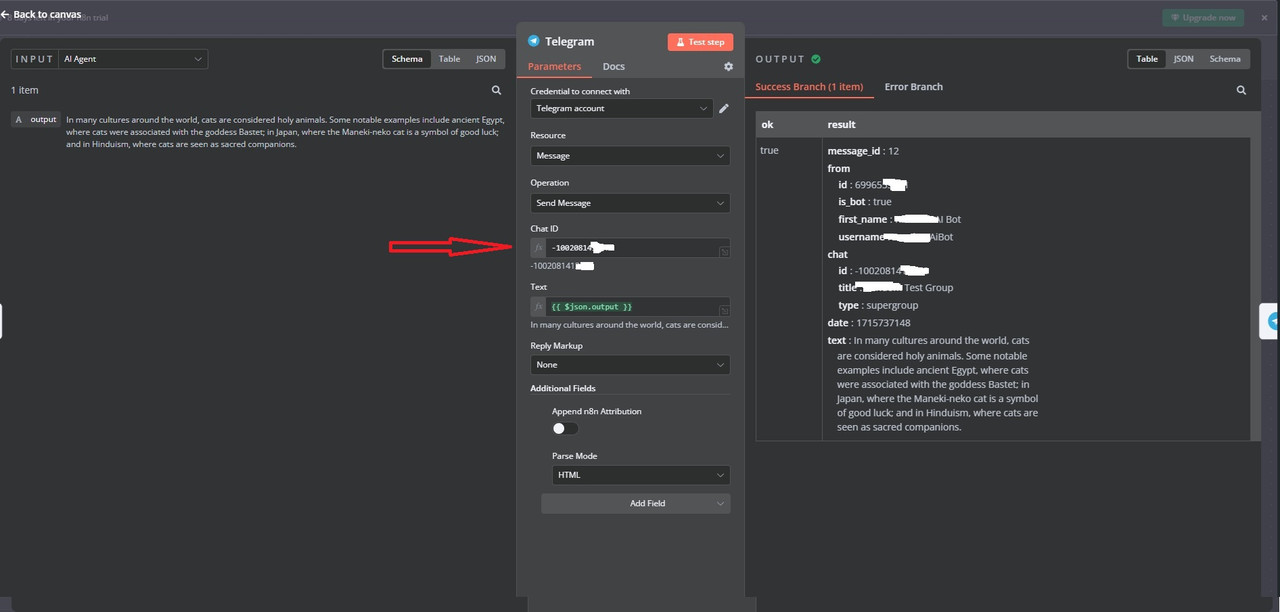

Dear ThinkBot,
Thank you for your prompt response and guidance. Following your instructions, I created a test group and added the Telegram bot as advised. However, despite mentioning the bot with “@” and sending commands, it responds to individuals via private messages instead of posting in the group chat as intended.
To illustrate the issue further, I’ve uploaded a screenshot displaying the bot’s behavior: https://i.ibb.co/hY2hRZP/ai-bot-help.jpg
Any additional insights or assistance you could provide would be greatly appreciated.
Thank you once again for your support!
Best regards,
Shano
We talked a little in the DMs but here was the final solution:
Did you say you were able to get the chat ID of the group? Can you try replace in the send message on telegram node where it shows chat ID and replace the code with that
Glad I could help.
Additional info for the curious:
Apparently the ID sent with the initial message to the bot, used in this flow, is actually the ID of the private message session with you and the bot. (Despite the message still originating from the group)
Replacing that code with the ID of the group the bot was added to, will allow it to reply there correctly and not your DMs.

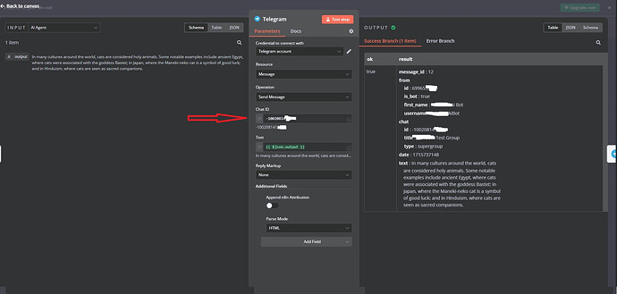

I would like to express my sincere gratitude to ThinkBot Agency for their unwavering assistance and patience in guiding me, an amateur, through various challenges. I highly recommend their services! Thanks to them, everyone in our group will now be able to enjoy generating cat facts and generating pictures of warrior cats, which I find amusing lol. I am also attaching a picture of the field where I made changes, hoping it may help others facing similar challenges.
