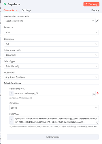

I have a RAG IA with supabase.
I need to make a RAG IA with postgres, but there are some commands in the supabase node that I don’t know how to use in the postgres node

I solved this by creating a query in postgres:
DELETE
DELETE FROM documents
WHERE metadata->>‘file_id’ ILIKE ‘%’ || ‘{{ $json.file_id }}’ || ‘%’;

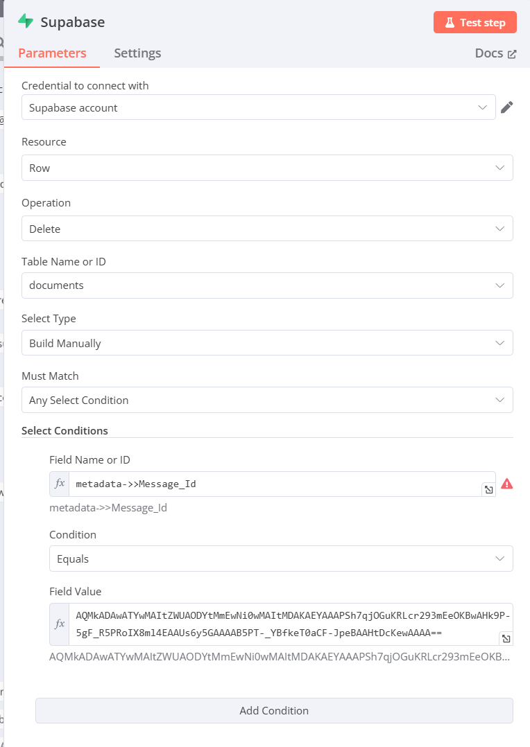

I am trying to the delete a document.
My metoda hes four fields, one of them is file_id. I find it impossible to get or delete document by this :confused:
Ok, did it myself :slight_smile:
